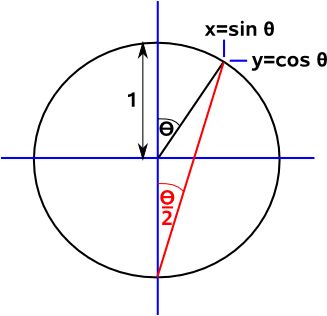

I searched for a formula like this, and found tons of stuff about the section of the circumference being c = rΘ , which is nice, but I need to see the Δx and Δy separately. I did find this:
But it has a radius of 1. Would I simply multiply sinΘ or cosΘ by the radius for it to work on other sized shapes?
Thanks again.

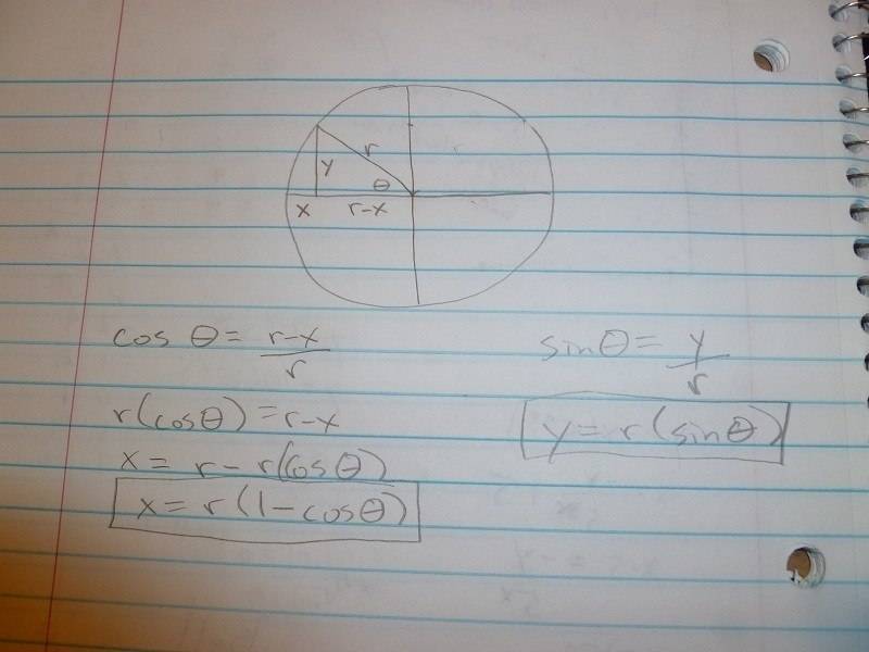

How does this math look for the first π/2 rotation?
And I understand what you mean now about φ and ψ, tiny-tim. You're saying I have to account for the fact that the center point does not sit on the axis when beginning the rotation, and goes past the next axis at the end of each quarter rotation.
hi brimby! :smile:
yes, that's right … you've chosen your coordinates with the origin (0,0) at one end of the diameter of that circle, so the coordinates of the centre of the rectangle are x = r(1 - cosθ) and y = rsinθ
but can you see that you're making things difficult for yourself in the future? …
when you plot the position of the rectangle, you instantly know where the corners of the rectangle are going to be (x = 0, a, a+b, 2a+b, 2a+2b, …), sooo it's easiest to plot the centre of the rectangle relative to the positions of those corners!
in other words: you really want your x and y in your diagram to be measured from the centre of the circle (not the end of the diameter): that will be x = rcosθ, y = rsinθ :wink:
yes :smile:
Likes 1 person
Yeah I definitely don't want my coordinates to have an origin at the edge of the circle. But wouldn't my version work in terms of Δx? My example rectangle is lying horizontally at the start, and rolling to the right. So that x at the edge of the circle would be a qualifying Δx as it moves right, right? In that situation x = rcos(Θ) would describe the movement left to go until it completes it's 90° turn, which isn't what I want.
One of the big errors I think I have been making is using sin(ΔΘ) and cos(ΔΘ), but I looked back on your post and I think you suggested Δsin(Θ) and Δcos(Θ). I'll have to wait until I get off work before I can go test it though. I think at first I assumed it was the same, but just thinking about it right now... yeah, they are completely different. :wink:
Sorry for always switching between x and Δx. Δx is truly what I want, as it makes more sense in terms of running my program.
So as it stands right now, I think my equations for the first quarter turn are:
Δx = r(1 - Δcosθ)
Δy = r(Δsinθ)
But if that isn't right, just tell me I'm wrong again. I'll believe you :wink:
hi brimby! :smile:
sorry, I'm not followng what you're trying to measure :confused:
(nor what ∆x is)
yeah! :biggrin:
∆x is the x position of the center of the rectangle minus the previous x position of the center of the rectangle. My rectangle isn't going to have the luxury of sitting at (0,0) in my game. It could be anywhere on the coordinate system, which is why I opt to use ∆x so I don't have to figure out where it is vs. where it was between each refresh... I just have to add or subtract the change between refreshes.
Does that make it more clear? So the reason I made ∆x be the little piece at the edge of the circle is because x1 (the tip of the radius on the x axis) is where the point was previously, and x2 (the corner of the triangle at x = rcosΘ) is where it currently is in its rotation. And I want to know the change, so I can add it to whatever the rectangle's previous x position was.
Hmmm. But I guess in that case, x1 isn't always going to be the tip of the radius on the x axis... Guess I'll have to ponder that one.
Yeah I thought about it for 2 seconds and you're right. Change in x equals the change in cosΘ. I'm a goof. Thanks though.
It only seemed that way to me because in that specific case where x1 is the very first point in the turn the change in r(1-cosΘ) is the same as the change in rcosΘ because x1 = r. Or something like that. Oops.
