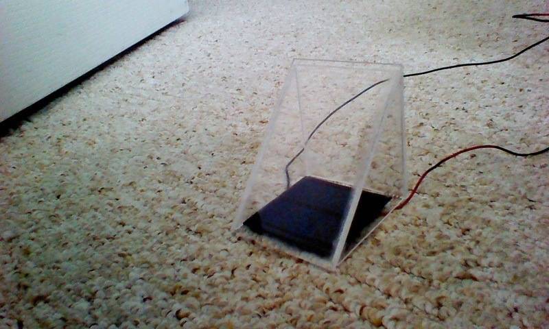

So, here's the deal: I'm trying to complete the publishing of a paper dealing with my thesis from almost two years ago, and I finally wrote a program that I believe will tell me how different geometries will influence the outcome.
Here's the setup, I am modeling the radiation that goes through the cover of a solar still (google WaterCone for an example of what a solar still is) and is absorbed by the basin. In order to verify that my ray tracing code is functioning properly, I have performed three experiments with small, polycarbonate "covers" placed over a solar cell. The solar cell is given a small load and the voltage over the load is measured over the course of the day. Assuming the voltage is proportional to the total radiation flux seen by the cell (which may not be the case, I'm not certain), the radiation distribution over the course of the day does not match what I would expect it should according to my ray tracing analysis.

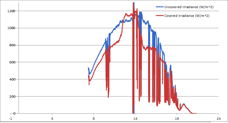

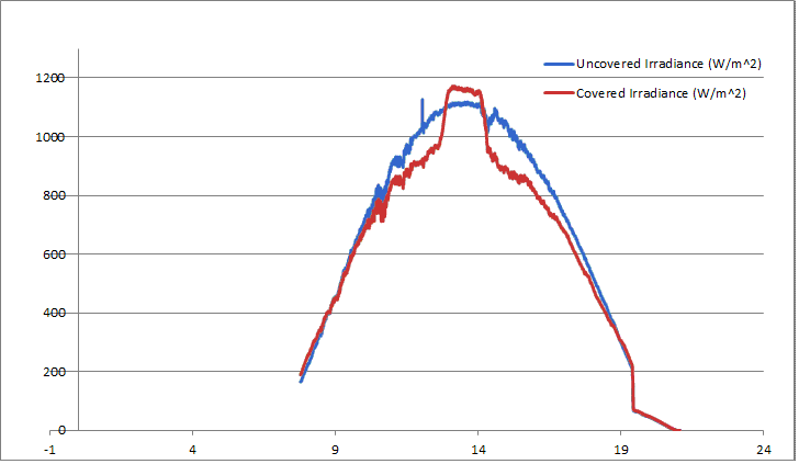

Attached is one of the data files (data file 1, with the data used to approximate the flux given the maximum solar radiation that day). The behavior as you may note, drops down a bit and then comes up in a small hump at solar noon. While, for the ray tracing done to approximate the same conditions, there is no center hump, it is one single curve without the jump at midday. Similar midday behaviors can be seen in the other covers (all are wedge shaped), as the back plate reflects some light that would otherwise be lost onto the solar cell.

Check, the ray tracing model accounts for both diffuse (sky) and direct (from the direction of the sun) solar radiation. The other surfaces part comes in where the surfaces of the cover can reflect light that would otherwise miss the cell back onto the cell, increasing the net radiation to the cell. Attached is an image showing that setup.

Correct, but the second half of the day some clouds moved in, causing it to drop a little bit after solar noon. Generally, there is some noise that is unavoidable due possibly different sources, like EM interference in the wires, clouds, shadows of animals, wind bouncing the wires around causing temporary disconnects, etc. If the "bump" was caused by something like that, we would expect to see something similar in the control case that was running simultaneously (the uncovered data).

I would assume that the polycarbonate shell does not perfectly transmit the light and instead reflects and/or absorbs some of the incident rays. That would account for the covered case being lower than the uncovered case. Might it be that as the sun passes directly overhead and has a less oblique angle, the reflectivity and/or absorptivity of the polycarbonate shell decreases, bringing the results more into line with the uncovered case? Actually, it looks like the two cases match fairly well except on the "shoulders" of the graph, so maybe there is a reflectivity/absorptivity issue at those specific angles and your ray-tracing model simply doesn't account for this.
That's kind of what I was thinking, but for the life of me I can't find the error in the code. I've even experimentally validated the directional reflectivity of the cover material (and I was surprised how well they fit the properties of a dielectric with n=1.49).
Yeah, so that's what I was thinking, something wrong in the ray tracing code. I'll have to track it down and figure it out. Anybody know of any good resources when it comes to freeware codes similar to what I would need?
