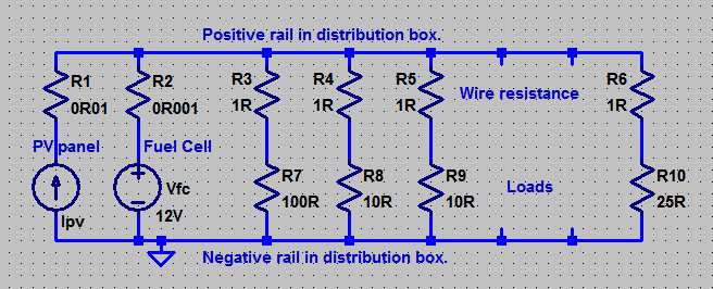

Hi all. In a project I'm working on I'm needing to model a DC circuit to find the required power sources/storage to keep the system voltages up to a sufficient level. There's a solar cell array, a reversible fuel cell stack, various DC "appliance" loads, and wire runs with resistances. I dug up some Kirchoffs' law code that I wrote and tested ages ago, but I'm mainly thinking now about the "appliance" loads at the moment
Often when you see a device it'll be rated for a certain voltage range and will have a specified current or power draw. But what I need for Kirchoffs' laws is internal resistances. Now, I can just get that from V=IR. Say we had a device rated for 10-15V DC with a power draw of 150W. For 15V we get the following:
150W: 150 = V * I = 15 * I; I = 150/15 = 10
V = I * R; V / I = R; 15 / 10 = 1.5. So 1.5 ohms.
Now for 10V:
150W: 150 = V * I = 10 * I; I = 150/10 = 15
V = I * R; V / I = R; 10 / 15 = 0,667. So 2/3 of an ohm
In short, we find double the internal resistance for the device if I assume the upper end of the voltage range rather than the lower end! But surely that's not going to happen in the real world, right? Would the safe bet be to assume that the power rating is only valid for some "nominal" voltage? Or should I use the upper or lower bound in calculating the internal resistance?
I'm also pondering how I should determine the wire diameters/gauges. Right now, all that comes to mind is picking some initial values and then either manually or automatically iteratively converging to diameters that keep all "appliance" loads above their minimum voltage rating at all times and don't exceed their current ratings. An iterative refining approach is also all that comes to mind for determining the sizing on the solar cell array and fuel cell stack.
Am I thinking about this wrong?

You have a fixed source voltage system. You do not need resistance for loads, you need only maximum surge and steady current requirements.
Make the fuel cell stack the centre of your wiring network, it sets the supply voltage and is the only source of current during the night. Loads radiate out independently from that terminal pair. Do not worry about iteration of cable size selection effecting other things. The star network will reduce that effect and make the problem tractable.
The PV will need an MPP controller to efficiently pass energy to the fuel cell stack. It can be considered independently.
Start by specifying a minimum of 1 mm2 for each wire. For greater currents use 0.1 mm2 of copper wire for each amp of DC load current. (Use 0.2 mm2 of copper wire for each amp of AC power current). The length of the cables needed has not yet been specified. You will need to use a greater wire section if the load is far away. Remember that each device has two wires, the return wire will double the resistance and voltage drop.
Tabulate the range of data for each load and for the line to that load.
Load n: Isurge, Icontinuous, Vmin @ Isurge, Vmin @ Icontinuous.
Line n: mm2, material, resistivity, length.

Attached to the two terminals of the fuel cell is a positive rail and a negative rail in the distribution box. Each load will be independently connected to those two rails by two wires. The PV panel also connects to those rails through two wires.
That is a star topology with everything in parallel, not series.
When the sun shines on the PV panel, it's voltage will rise above the fuel cell voltage and charge will flow into the FC, (and support some load). The PV panel voltage will be selected as sufficient when illuminated to exceed the FC voltage, the PV voltage will then be held down by the fuel cell as a PV panel is a current source and the FC is a fixed voltage device.
So in your diagram above R1 and R2 must be the internal resistances, and vary with load. Because they're absolutely essential to modeling a realistic system, as without them a tiny solar cell would be the same as a thousand wired in parallel, and a fuel cell stack with 1cm² layers would be the same as one with 1m² layers. There's no shunt path in the PV panel in the diagram, which is a problem with real world photovoltaics, but that's at least something that can be worked around (with the assumption that this is reflected in the generation curves and that there's some hardware somewhere to prevent discharge through that path at night)
How are you suggesting that R1 and R2 be calculated without Kirchoffs' laws? You have a multi-loop circuit in the above, with two sources of EMF.
Let's calculate a simplified version - let's remove R7 from the diagram, and everything to the right of there, so that there's only one load resistor (R3) connected to the panel and fuel cell (and their internal resistances). So we have two junctions (the ones drawn above and below the fuel cell), presenting:

KarenRei said:
Is this relevant? Absolutely.
The voltage drop across R1 is irrelevant because a PV panel is a current source. R1 causes slight energy inefficiency.
The voltage drop across R2 is irrelevant as the load resistances are so much greater than R2.

The voltage drop across R2 is absolutely not irrelevant, as the overpotential is a key factor in the efficiency of a fuel cell. Less than the minimum and the reaction doesn't proceed. More than the minimum and it's wasted to heat. It also affects the internal resistance (aka R2 itself)
Both R1 and R2 affect the voltage drop across R3, as you can see in the above.
You can't just say "the load resistances are so much greater than R2" (or R1 for that matter) when determining the maximum acceptable values of R1 and R2 is one of the main goals . You're begging the question.
Please read the first complete sentence written in this thread, right at the very top:
The whole point is to size the solar system, fuel cell stack, and wiring. You're ignoring the first two parts of that and focus only on the wiring. I mean, well, clearly if you can just assume that the internal resistance on the power side is irrelevantly small then of course you don't need Kirchoff's Laws. But that's not the issue at hand. You're not going to add a square kilometer of solar panels and a fuel cell stack the size of a house to power an iPhone, or whatnot. You have to size things appropriate to the task at hand. And that requires solving for the appropriate size.
That established, can we get back to how one best determines the internal resistance of a piece of hardware based on its rated power consumption and voltage range (minimum voltage, nominal, or maximum? My thought is that they'd base that on the nominal voltage - right?) Also, trying to resolve whether an iterative multivariate refinement is best for sizing the solar system, fuel cell system, and wiring, or whether there's a better approach.
