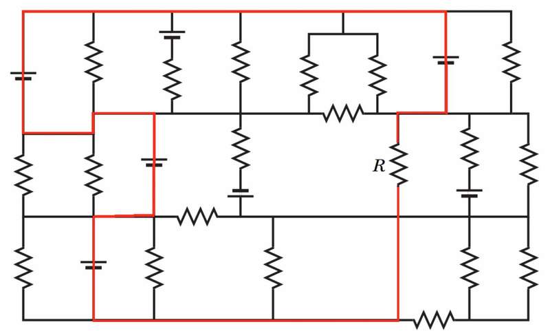

Res-monster maze. In the following figure, all the resistors have a resistance of ##4.0 \Omega## and all the (ideal) batteries have an emf of ##4.0 V##. What is the current through resistor ##R##?
##\sum V = 0##
##\sum I = 0##
##V = \epsilon##
##V = IR##
See the attached image.
When I look at it, I see two loops. The big loop to the left of ##R## and the smaller loop to the right of it. Would I just apply the equations in that sense?
Left loop:
##\epsilon_1 - i_1R - i_2R' - i_3R'' = 0##
Right loop:
##\epsilon_2 - i_4R''' + i_5R = 0##
EDIT: Wait what if I just find an equivalent resistance for that one standout parallel resistor combination?
The easy way is to see whether there exists a string of nothing but pure voltage sources between one end of R and its other end. Any other method will be many orders of magnitude more complicated. :wink:
You know how to play snakes-and-ladders, right?
Likes Eashan Roy and STEMucator

I attached a picture of what I think you mean.
Writing the loop equation now:
##iR + \epsilon_1 - \epsilon_2 - \epsilon_3 - \epsilon_4 = 0##
##i = \frac{- \epsilon_1 + \epsilon_2 + \epsilon_3 + \epsilon_4}{R}##
##i = \frac{8.0 V}{4.0 \Omega}##
##i = 2 A##

That looks right.
