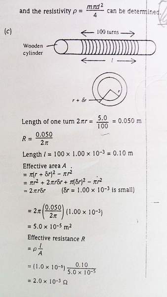

what's the difference between case a (photo 1&2) and case b (photo 3 ) ? what can't i use the way of doing case b for case a? p/s : my own working for case a in photo 4

Do you have any reason to think they should be handled differently?
Please show how you are thinking about these problems?
for case a , i do it in this way because since the length is already given , I sub l=0.05m (case b provide radius only, so i use 2pi r to find the total length in a coil) , area= uniform cross sectional area, 1.0mm^2
For case (a) the length of the wire is given, not the length of the coil.
If you just put a current down the straight wire, you'd use ##R=\rho L/A## where L is the length of the wire and A is it's cross-sectional area.
But the problem writer is making a big deal out of the fact the wire is not straight and it isn't a regular wire.
i.e. It says the wire has a square cross-section - why is that important?
How would wrapping the wire into a coil make a difference?
Is it important that the wire is un-insulated?
Is it important that the sides of the wire touch each other?
