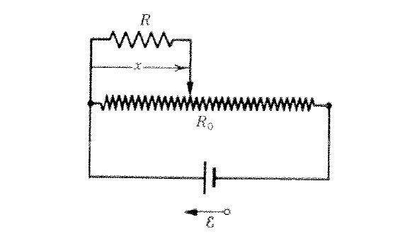

Figure 29 shows a battery connected across a uniform resistor R0. A sliding contact can move across the resistor from x=0 at the left to x=10 cm at the right. Find an expression for the power dissipated in the resistor R as a function of x. Plot the function for ℰ=50 V, R=2000Ω , and R0=100Ω
P=\frac{V<sup>2</sup>}{R}
I have no clue at all on how to solve this problem. I think that it might have to do with how resistors are adding up in parallel. I really can't see which one is in parallel. I don't see how to determine the resistance with the varying x.
This circuit is equivalent to three resistors: Rl, Rr, and R. Rl and Rr are the left and right, correspondingly, parts of Ro; their values depend on x. Solve for voltage at R and current through it.

may be this be help..
R_{total}=(R // R_{p}) + R_{s})
just as Voko said #2
