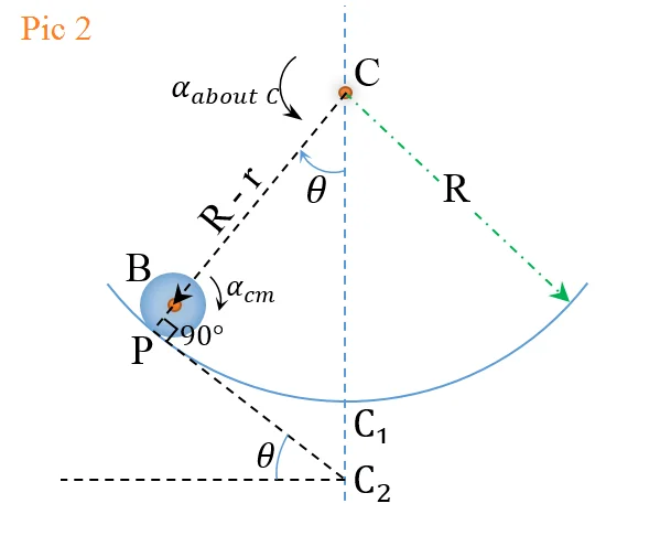

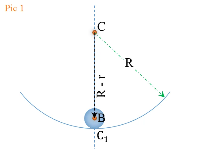

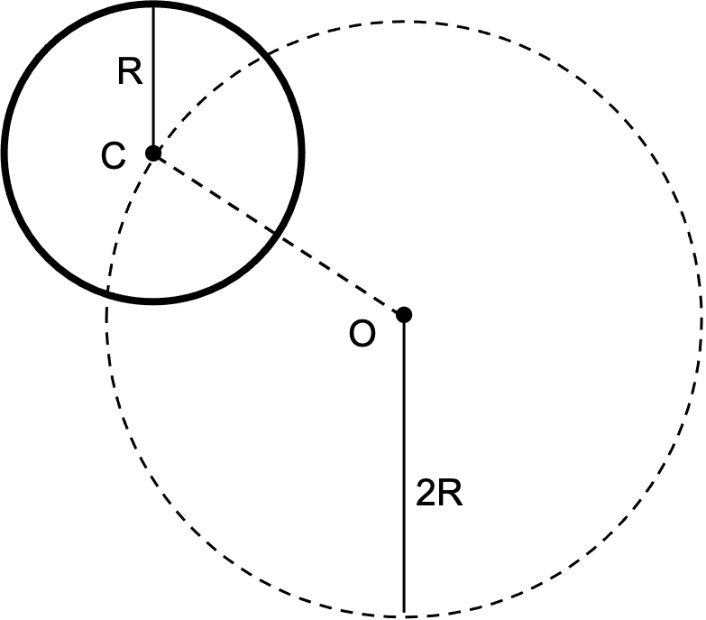

This is what I mean: In this pic(Pic 1 below), when the ball is just lying at the bottom most point on the concave surface and is not rotating at all, the moment of inertia of the ball about the axis passing through point C, and perpendicular to the page, is = ##\frac{2}{5}mr^{2} + m \left ( R-r \right )^{2} ##. I suppose you'll agree up to this point. In this situation, perpendicular axis theorem for calculation of moment of inertia has been correctly applied. I suppose you'll agree to this too.
However, now take a look at this pic(Pic 2 below), when the ball is rotating about an axis passing through it's own centre of mass, i.e. point B and perpendicular to the page, and also simultaneosuly rotating about an axis passing through the point C(centre of curvature of concave surface) and is perpendicular to the page.
According to @haruspex's comment in post#26:

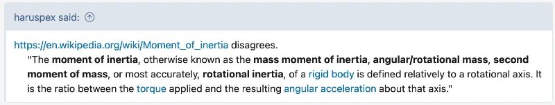

haruspex said:
Your mistake is in applying the parallel axis theorem. That is only valid for a rigid body rotating as a unit about the axis. It would be correct if the sphere were a pendulum bob attached rigidly to a rod. In the present case, the motion of the sphere about its centre and the motion of that centre about the axis are rather different.
and in post#33
haruspex said:
The parallel axis theorem applies to a rigid body rotating, as a whole, about a given axis.
But in your post#42, you've clearly mentioned that:
kuruman said:
As you can see, there is no mention about rotation anywhere in this procedure.
meaning that calculation of moment of inertia is NOT dependent on whether the body is rotating or not.
So, what I gather from these posts is that @haruspex is saying is that the 2 conditions(shown in the 2 pics above) are different even regarding the calculation of moment of Inertia. According to him, the moment of Inertia in the 2nd case(when the ball is rotating about 2 axes simultaneously), is NOT = ##\frac{2}{5}mr^{2} + m \left ( R-r \right )^{2} ##. This is what I don't understand, since in post#40, he does agree that mass distribution doesn't change just because the ball is now rotating. And moment of inertia is just a measure of how the mass is distributed about an axis. So my contention is that in this 2nd case too, the moment of Inertia of the ball about the axis passing through point C and perpendicular to the page should be = ##\frac{2}{5}mr^{2} + m \left ( R-r \right )^{2} ##.
kuruman said:
Look, the definition of the moment of inertia is I=∫dm r2. It is a step by step procedure for finding the moment of inertia about an axis.
Appreciate the point-wise refresher course on how to calculate moment of inertia. However, I already know that and that's not what I was asking for.
I want to know what will be the moment of Inertia of the ball about the axis passing through the point C and perpendicular to the page, in the case when the ball is rotating about 2 axes simultaneously(as shown in Pic 2). In my opinion, it should be = ##\frac{2}{5}mr^{2} + m \left ( R-r \right )^{2} ##.

  • #44
NTesla said:
my bad. I mistakenly wrote "wouldn't", when it should have been "would".
The correct statement is: If the mass distribution doesn't change just because the ball is rotating, this means the moment of inertia should not change just because the ball is rotating. If so, why would the moment of inertia of a ball rotating about its own axis and also simultaneously about an axis passing through C, change from that calculated when it wasn't rotating at all.?
However, now take a look at this pic(Pic 2 below), when the ball is rotating about an axis passing through it's own centre of mass, i.e. point B and perpendicular to the page, and also simultaneosuly rotating about an axis passing through the point C(centre of curvature of concave surface) and is perpendicular to the page.View attachment 366238
and in post#33
As I wrote in post #28, the moment of inertia of a body is only of interest in the context of rotation about some axis. To put that more forcefully, it is only defined in respect of its actual or potential rotation as a rigid body about a specified axis - i.e., a motion in which every part of the body is rotating at the same angular rate about that axis.
Specifically, if an element dm is at r from the axis then its contribution to the angular momentum when the body is rotating at ##\omega## about the axis is ##\omega r^2~dm##. To get the total angular momentum we can sum these ##\int\omega r^2~dm=\omega\int r^2~dm##. Note that the ability to move the ##\omega## outside the integral depends on the conditions I stated.
From this result, we see it is convenient to consider ##I=\int r^2~dm## to be a property of the rigid body and the chosen axis.
For any other axis the MoI may be different, and for a motion of some other kind it is not meaningful at all.

To find the moment of inertia about C, you use the parallel axis theorem. It is the moment of inertia about the center of mass of the ball plus the moment of inertia about C is the entire mass of the ball were concentrated at its center:##~I_C=I_{cm}+m(R-r)^2.## Now the moment of inertia of a sphere about an axis going through its center is ##I_{cm}=\frac{2}{5}mr^2##, therefore $$~I_C=\frac{2}{5}mr^2+m(R-r)^2.$$Note that the subscript ##C## specifies about the axis about which this moment of inertia is calculated and that it depends only on ##m## and the geometric quantities ##r## and ##R.## Also note that moment of inertia of the ball about its CM is different from the expression about point C.
Does this help your understanding?

In my calculation that I have attached as pdf in post#24, I have already written that ##I_{about C} = \frac{2}{5}mr^2+m(R-r)^2.## and then have proceeded to calculate the time period.
Thereafter, in my post#43, I again mentioned that:
NTesla said:
So my contention is that in this 2nd case too, the moment of Inertia of the ball about the axis passing through point C and perpendicular to the page should be = 2/5mr2+m(R−r)2.
In that same post, at the end I reiterate that:
NTesla said:
In my opinion, it should be = 2/5mr2+m(R−r)2.
But apparently you missed that thrice.

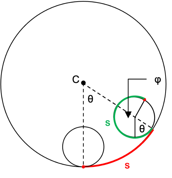

It is a fact that the parallel axis theorem correctly calculates the MoI about any point when the ball is at rest at the equilibrium position. The question is how one uses correctly the MoI thus calculated for whatever one wants to do. Let's say we want to calculate the total angular momentum about point C.
According to parallel axis theorem the moment of inertia about point C is ##I_C=\frac{2}{5}mr^2+m(R-r)^2.##
Case I
The ball is at the end of a light rod and is going around in a circle with angular speed ##\dot{\theta}##. The angular momentum of the ball about point C is the sum of two terms.
The first term is orbital angular momentum of the ball's CM about C with angular speed ##\dot{\theta}##: ##~L_{\text{orb.}}=m(R-r)^2\dot{\theta}.##
The second term is spin of the ball about its CM with angular speed ##\dot{\varphi}##: ##~L_{\text{spin}}=\frac{2}{5}mr^2\dot{\varphi}.##
Now the spin angular velocity ##\dot{\varphi}## is the same as ##\dot{\theta}## because the ball goes once around its axis as it goes once around point C. It's the same kind of motion that the Moon undergoes as it orbits the Earth. The orbital period of the Moon is equal to its spin period hence it presents the same face to the Earth at all times. Thus, ##~L_{\text{spin}}=\frac{2}{5}mr^2\dot{\theta}##
The total angular momentum of the ball in this case is $$L_{\text{tot.}}=L_{\text{orb}}+L_{\text{spin}}=m(R-r)^2\dot{\theta}+\frac{2}{5}mr^2\dot{\varphi}=I_{C~}\dot{\theta}.$$ Case II
The ball is rolling inside the spherical shell as in this problem.
The relation ##L_{\text{tot.}}=L_{\text{orb}}+L_{\text{spin}}## is still valid but the relation between orbital and spin angular velocities is not. The rolling without slipping constraint, corrected from post #14, can be found using the diagram on the right, $$s=R\theta=r(\theta+\varphi)\implies \varphi=\frac{(R-r)}{r} \theta.$$The angular momentum about C is $$\begin {align}
L_{\text{tot.}} & = L_{\text{orb}}+L_{\text{spin}} =m(R-r)^2\dot{\theta}+\frac{2}{5}mr^2\dot{\varphi} \nonumber \\
& = m(R-r)^2\dot{\theta}+\frac{2}{5}mr^2\frac{(R-r)}{r} \dot{\theta} \nonumber \\
& = m(R-r)\left(R-\frac{3}{5}r\right)\dot{\theta} \neq I_{C~}\dot{\theta}. \nonumber
\end{align}$$
  • #56

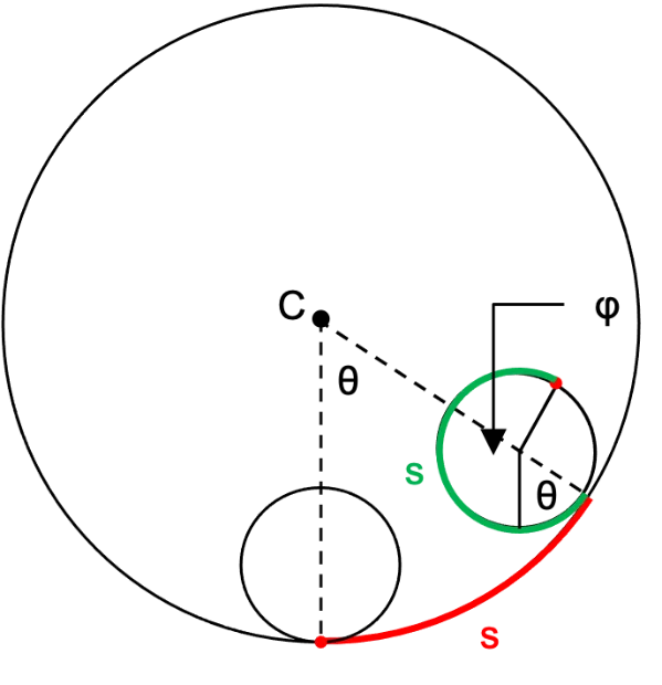

Case I
View attachment 366299The relation ##L_{\text{tot.}}=L_{\text{orb}}+L_{\text{spin}}## is still valid but the relation between orbital and spin angular velocities is not. The rolling without slipping constraint, corrected from post #14, can be found using the diagram on the right, $$s=R\theta=r(\theta+\varphi)\implies \varphi=\frac{(R-r)}{r} \theta.$$The angular momentum about C is $$\begin {align}
\end{align}$$
https://en.wikipedia.org/wiki/Moment_of_inertia disagrees.
"The moment of inertia, otherwise known as the mass moment of inertia, angular/rotational mass, second moment of mass, or most accurately, rotational inertia, of a rigid body is defined relatively to a rotational axis. It is the ratio between the torque applied and the resulting angular acceleration about that axis."​
  • #57
OK, can you help me figure out how to apply this definition in the case of the rolling ball? There are two torques acting on the ball, one from gravity acting on the CM and one from static friction acting on the point of contact. I assume that "by the torque applied" the wikipedia definition means the net applied torque. That is easy to figure out as $$\boldsymbol {\tau}_{net}=-R~f_s(\mathbf {\hat r}\times\mathbf{\hat{\theta}})+(R-r)mg\sin\theta~(\mathbf {\hat r}\times \mathbf{\hat{\theta}}).$$ What about "the resulting angular acceleration about that axis?" that is needed for the ratio? Is it simply the vector sum of the orbital and spin terms?

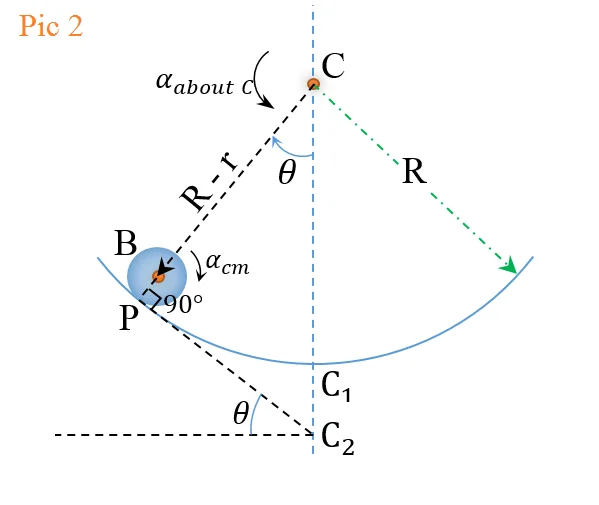

Here's the calculation taking the angular momentum about point C.
## L_{aboutC} = -mw_{C}(R-r)^2 + \frac{2}{5}mr^2w_{cm} ##
and using the equation: ##w_{cm} = \frac{R-r}{r}w_{c}##, we get:
## L_{aboutC} = \left ( -R^2 - \frac{7}{5}r^2 + \frac{12}{5}rR\right )mw_{c}##
Differentiation both sides wrt t, we get:
##\tau _{C} = \frac{\mathrm{d} L_{about C}}{\mathrm{d} t}## = ##\left ( -R^2 -\frac{7}{5}r^2 + \frac{12}{5}rR\right )m\alpha _{C}##
and ##\tau _{C} = -\left ( mgsin\theta (R-r) - \frac{2}{7}mgRsin\theta \right )##
This gives, ##\alpha _{C} = - \frac{\left ( \frac{5}{7}R - r \right )gsin\theta}{\frac{12}{5}rR- R^2 - \frac{7}{5}r^2}##.
But this is not correct value of ##\alpha _{C}## which could give the correct value of time period. I don't know what am i missing or doing wrong.
  • #60
Which reduces to ##\frac {5g\sin(\theta)}{7(R-r)}##.
Do you know what the answer is supposed to be?
