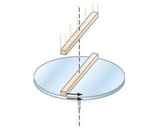

A uniform disk turns at 3.7 rev/s around a frictionless spindle. A nonrotating rod, of the same mass as the disk and length equal to the disk's diameter, is dropped onto the freely spinning disk . They then both turn around the spindle with their centers superposed. What is the angular frequency in rev/s of the combination?
L = Iω
I was trying to relate the angular velocity to this but I don't think that's the correct approach. For example, on my second attempt I had:
ω = L / (1/6)(M)(l)^2
(3.7 rev/s)(6) = 22.2 rev/s
I'm having trouble finding a connection.

Think inelastic collision angular style!

One problem here: the expression for the moment of inertia of a disk is not the same as that of a thin rod. Use the expression for a disk to determine the system's angular momentum. Use a common measure for the radius of the disk and the length of the rod (so if the disk's radius is r, then the rod's length is 2r).

You won't need to make a proportion if you simply equate the expression for the angular momentum after collision to the expression before. You should find that in solving for the new angular velocity that a LOT of stuff is going to cancel out :wink:
Ok. I think I have this figured out.
The initial moment of inertia is just the disk. 1/2 Mr^2.
Once the disk is added, the final moment of inertia is 1/12 M (2r)^2 + 1/2 Mr^2 = 5/6 Mr^2.
So now I can make an equation relating the two:
3.7 rev./s (1/2 Mr^2) = 5/6 Mr^2 * ω
ω final ≈ 2.2 rev./s
That looks much better! :smile:
