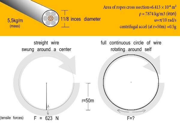

Hey Steam King that is really helpful i will need that too for my design, But i think that you just described a wire 50 m long being swung with L=50 around a center.
Sorry but i meant a full circle made out of wire, r=50 is just an indication for the size of that circle.
The L of the circle is 314.1592 that's why the mass of 1729,82~Kg :( Sorry if i put you in trouble with my first post, but i need that tension too anyway, and i appreciate a lot your detailed response.Hope your not angry.
In that case is my previous post correct if i may ask?
Hello, i made an image, hope this helps, the 623 N are for the first case (straight wire swung around a center) right?
All right, I see what you want to calculate now.
If you cut the loop across its diameter, you'll wind up with two ends of rope located 100 m apart. Due to the rotation of the loop about its center, the centrifugal force acting on the loop wants to pull it apart. The force acting on each end of the rope will be:
F = m ⋅ ω2 ⋅ r2
Here, m is the mass per unit length for the rope.
So the force F = 5.05 ⋅ (π/10)2 ⋅ 502 = 1246 N at each end of the loop.

It's not clear why ρ = 5747.6 kg/m3 here, unless the rope is not solid iron. If you have a wire rope made by weaving many strands of smaller wire together, then the cross section of the rope will vary, depending on the method of construction.
So in an area equal to a slice of wire i found a force that is exactly double than the F in the previews post.
Should i use 1246 or 2492 as the real tensile force within the wire:? (Im i litle bit confused)
The tensile force is like this:
Code:
1246 N   <--  o--------------------------------o  -->  1246 N
                              wire
