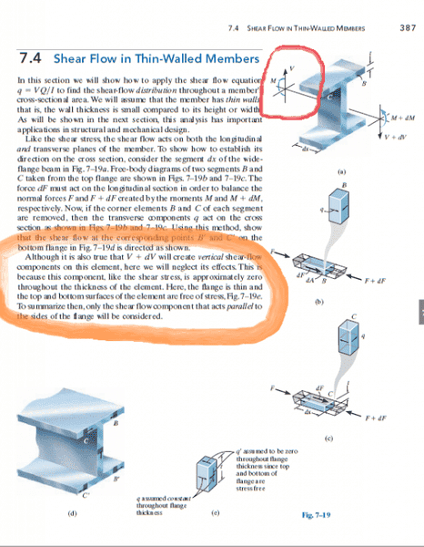

In the notes , I don't understand that flange is thin , and the top and bottom surface are free of stress , can someone help to explain please?
Secondly , why the q' is assumed to be q ' throughout the flange is assumed to be 0 ? why are they stress free ? We could see that , the shear force V is applied to the top of the beam right ?
why are they stress free ? We could see that , the shear force V is applied to the top of the beam right ... So , there must be some magnitude of stress acting on top or bottom or the beam [/B]
  • Textbook page 387 showing Section 7.4 on shear flow in thin-walled members, with diagrams of an I-beam, free-body diagrams of flange segments and a close-up of a thin flange element with stress-free top and bottom surfaces.

that is right. The transverse Horizontal shear stresses ( and accompanying longitudinal shear stress) are non zero on the flange except at the ends. The reference to zero shear stress in the flange is talking about negligible vertical shear stress in the flange due to assumed thin wall.
why the wall is thin , and the shear stress is negligible ? ?

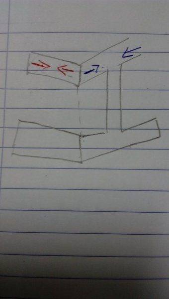

do you mean likt his ? in the notes , it's stated that the shear flow components that acts parallel ro the sides of flange will be considered ?
Does it mean that the red shear flow will be considered ( since it's side of flange) ? while the blue shear flow will be ignored since it's top and bottom are free of stress ?
  • Hand-drawn pencil sketch on lined paper of a thin-walled channel section with a flange, showing red arrows along one flange and blue arrows along the web, indicating shear flow directions.
The plot thickens. The blue (horizontal shear flow) and the red (longitudinal shear flow) exist simultaneously. You can't have one without the other. What is ignored is the small vertical shear stress in the flange, assumed to be zero since the web carries almost all the vertical shear. Also, you have an extra red arrow in there pointing in the wrong direction.

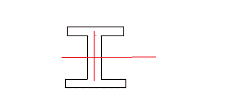

is my theory of
to find horizontal shear stress , we have to cut vertically , since the 'thicnkness' at the web is large , so the horizontal shear stress is so small compared to the horizontal shear stress at web , so , horizontal shear stress at web is negligible ? only the horizontal shear stress at the flange is considered ?
wrong ?
fonseh said:
is my theory of
wrong ?

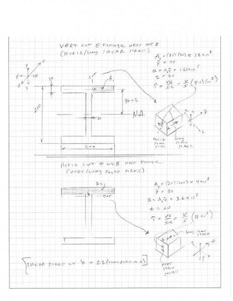

For an I beam, in order to find the longitudinal shear stress in the flange at a vertical cut thru the flange, you use the area to the right of the cut in calculating Q, and then the longitudinal shear stress acts into the plane ( along the beam ) parallel to the face of the cut, and along the side of the cut. In order to find the longitudinal shear stress in the web at a horizontal cut thru the web, you use the area above the cut in calculating Q, and then the longitudinal shear stress acts into the plane ( along the beam ) parallel to the face of the cut, and along the top of the cut.
In looking at a vertical flange cut near the web, the shear stress is about 1/2 the shear stress of a horizontal web cut near the flange, because the Q area for the former is about half the Q area of the latter. Neither stress is very significant unless you have a built-up beam requiring nails or welds in which case the concept of shear flow determines weld size or nail spacing.

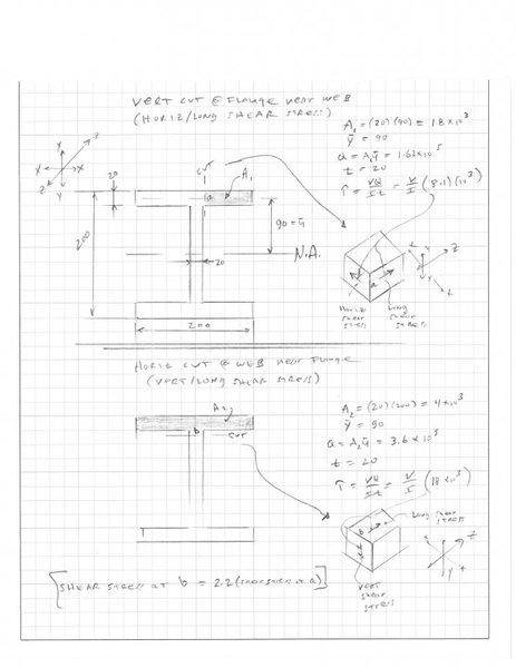

I don't know what these numbers are that you are using.
There are generally 3 directions of shear stress in a member...vertically up and down along the cross section, horizontally left to right or right to left along the cross section, and longitudinally into and out of the plane of the cross section.
In the web, shear stresses are vertical and longitudinal. The stresses are determined by cutting horizontally at the point of interest, and using the Q value of the area above the cut, and then the longitudinal stresses act at the top and bottom of the cut face, into the plane. There are no horizontal shear stresses in the web , since if you were to make a vertical cut thru the entire web, the Q to the right of the cut would be zero, since the centroid of the area to the right of the cut is at the neutral axis, such that the vert distance from the centroid to the NA is 0.
In the flange, shear stresses are vertical, horizontal, and longitudinal. The horizontal stresses are determined by cutting vertically at the point of interest, and using the Q value of the area to the right of the cut, and then the longitudinal stresses act at the side of the cut face, into the plane. There are small average vertical shear stresses in the web , which are typically ignored except when designing welds for a cover plate over the flange. The assumed zero vertical shear stress in the web, and its associated longitudinal stress , designated as (q'), is shown in figure e of the 1st post. The horiz shear stress , q, is non-zero.

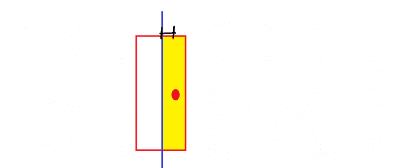

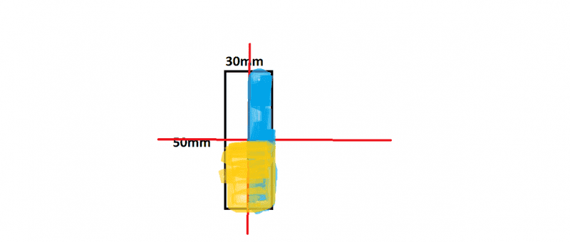

the diagram represent the web , if i apply a vetical cut thru the center of the web , the centroid of the area is the red dot , so , the y in Q = Ay is measured from the center to the centroid of the yellow area , why you said that y = 0 ? I'm confused
  • Diagram of a thin rectangular cross-section outlined in red, with a blue vertical line on its left side and the right half shaded yellow; a red dot marks the centroid of the yellow area and a small black mark sits at the top.
If you apply a vertical cut thru the web, the area to the right of the cut is the blue area. Its centroid is at the NA. The vertical distance from the centroid to the NA is 0.

When applied beam loads are in the vertical direction, the NA is horizontal no matter of the cut location
fonseh said:
I'm confused now . in post 14 , you said that the shear stress is about 1/2 the shear stress of a horizontal web cut near the flange , but in post 16 , you said that the centroid of the area to the right of the cut is at the neutral axis, such that the vert distance from the centroid to the NA is 0.
Post 14 is vert web shear stress close to the top flange. Post 16 is horiz web shear stress at NA. No part of the web, top , mid, or bot, has horiz shear stress. Attached shows horiz shear flow in flange

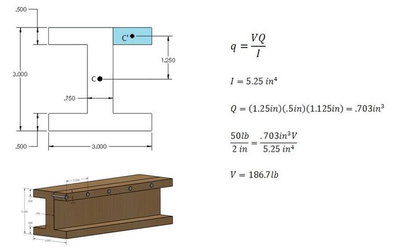

  • Cross-section diagram of an I-beam with dimensions 3.000 wide, 3.000 tall, flange and web thicknesses of .500 and .750, centroid C and point C' marked, plus a 3D isometric view of the beam with a shaded flange area.
Can you explain it further with diagram ? i don't understand . Why Q area for the former is about half the Q area of the latter ?
Since you said that Q area for the former is about half the Q area of the latter., so for a vertical flange cut near the web, the horizontal shear stress is about 1/2 the shear stress of a horizontal web cut near the flange... Is it true ?
Yes, about a half, , since the area to the right of a vert cut in the flange is about 1/2 the area above a horiz cut in the web, and the ybar of each area is the same.. I'll try to sketch something tomorrow.
