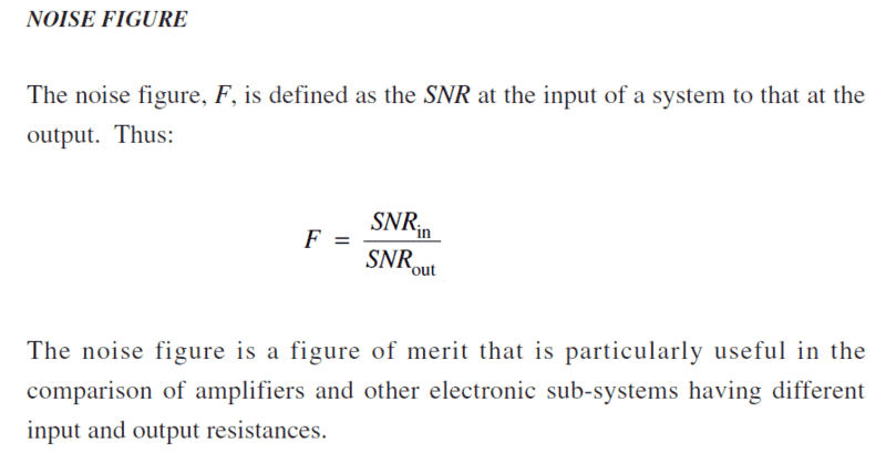

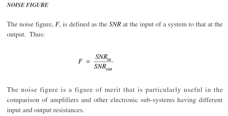

Then as I have the Noise figure from the data as F=6dB I can do the following:
F=SNRIn/SNROut
SNROut=SNRIn/F
SNROut=45*6
SNROut=270dB
This seems far too high? I have found websites that say the formula is actually F = SNRIn-SNROut however the learning materials say:
I think you are correct as far as part (b). Then you know the SNR at the input, and the SNR at the output will be 6dB worse. So SNRout = 45 - 6 = 39dB.
Hi thanks for the reply and assurance, do you have any idea why my learning materials is citing the noise figure equation incorrectly?
Yes, the formula for F is not stated in decibels. To divide decibel quantities we subtract, not divide.
