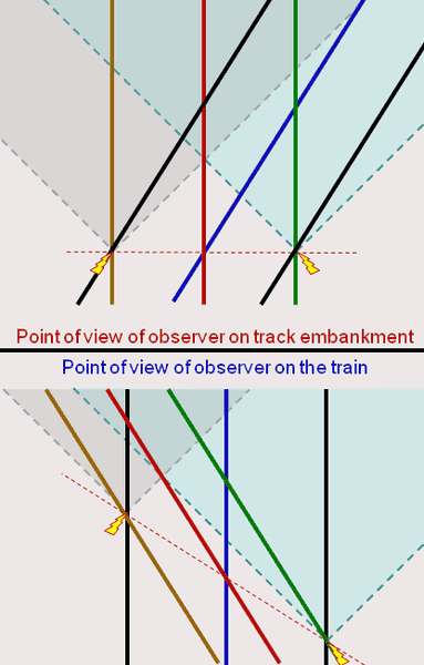

  • #38
True - Einstein does assume that the laws of physics are true in all inertial frames and it is from that that the Lorentz equations are derived (the constancy of c being the central or core theme.) But, as you say, his example of the train and embankment does not require that the laws of physics be the same. Of course, if the laws of physics were different in different inertial frames, I suppose it would be possible for one to offset a non simultaneity by a fluke of a complementary action by a different law of physics in another frame. Of course, Albert did not go into that.
  • #39
If for the observer on the platform the time at which the front strike occurs is t=0 then the time the back strike occurs must also be t=0.
According to the Lorentz transformation for time: t’= gamma(t – (vx/c^2))
Then the passenger must have seen the front strike at t’=-gamma(vx/c^2) and the back strike must have occurred at t’=-gamma(vx/c^2)
Where gamma, v, x, and certainly c are not different in either of the time equations to describe the front and back strike.
t-t=0
t’-t’=(-gamma(vx/c^2))-(-gamma(vx/c^2))=0

  • #41
My mistake, so let me make sure I'm going about this the right way.
I'm going to give numbers to all these variables.
t for front strike and back strike = 0
v=.8c
length of train=L=100
X coordinate for front strike = .5L = 50
X coordinate for back strike = -.5L = -50
For front strike:
t' = 0 - ((.8c)(50)/c^2) * gamma
gamma ends up being 5/3
t' = -2.22E-7
Does this mean the front strike for the observer on the train happens before the front strike for the observer on the platform?
For the back strike:
t' = 0 - ((.8c)(-.5L)/c^2) * gamma
where gamma again equals 5/3
t' = 2.22E-7
So the back strike for the train observer happens after the back strike for the platform observer?
And the delay between the front strike and back strike for the observer is 4.44E-7s ?
Did I just correctly confirm why the flashes are not simultaneous in the train frame of reference?

  • #44

  • #46
ValenceE said:
Agreed to all of the above, but, for me, in no way does this prove or demonstrate that the flashes didn’t happen simultaneously.
You are still talking as if simultaneity is an absolute. In whose frame ?
... since both strikes happen at t=0 doesn’t that make them simultaneous for all observers?
Definately not. The fact that the strikes happen at t=0 only applies to some observers.
You must try to understand that if two events are separated spatially, there is no way to define whether they are 'simultaneous' except by adopting a convention.
If I'm in the middle of the carriage and I send beams to the ends at the same time by my clock, the beams appear to me to reach the ends at the same reading on my clock. This will also be true for anyone on the plane perpendicular to the length of the carriage and passing through my position in the middle.
Other observers will say that the beams did not reach the ends at the same time on their clocks.
Simultaneity is relative.

  • #70
Doc Al said:
Yes, the video is misleading and sloppy in that regard.
I have made an animated gif of the train thought experiment showing both the point of view of the observer on the train and that of the observer on the track in a split screen, that I hope is more accurate than the youtube video mentioned in the OP.
This is the link to the animation: http://i910.photobucket.com/albums/ac304/kev2001_photos/Etrain2e.gif (It might take a minute to load on a slow connection.)
54
