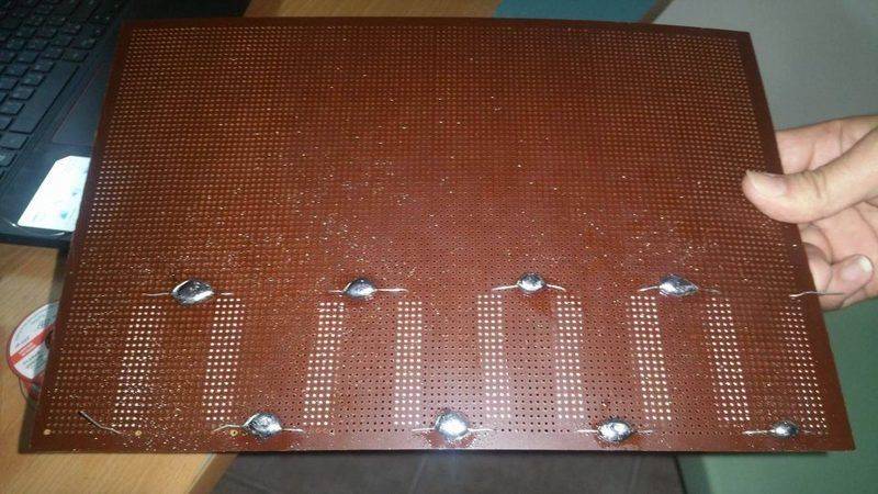

I am creating a lightning impulse voltage generator as my final year project and have been provided with most of the circuit. My only job is two create two resistors and a capacitor.
I will be creating a 1.25nF capacitor using 10nf 10kv capacitors.
My question here is that I've heard a lot that when handling capacitors, you can get shocked especially if its a high voltage capacitor. Well ill need to solder 18 capacitors (36 in total) [ 18 capacitors in series, 2 legs in total, connecting them parallel ]and make two legs so they can handle 140kv at least.
Now here is my question. What precautions shall i take when soldering the capacitors in order not to get shocked? As for soldering the capacitors, I am going to try and make the the soldering spherical balls and then will use sandpaper to make sure there are no sharp edges. I do not want to get shocked and I've heard capacitors get charged by static electricity as well and i usually do my soldering next to a laptop playing songs and generally beside many electronics etc.
I just don't want any accident happening since i am doing all my soldering at home and will do the rest of the work in the High Voltage lab. I don't have much access to the high voltage lab because i am not allowed to stay there unsupervised and after hours. So id like a solution which would allow me to work at home without much problems.

Okay thanks for the clarfication dave :) Please excuse for my lack of knowledge. Not necessarily spherical balls but more like. Hmm, a picture would be better.
Basically this is what i did. Not necessarily spherical balls but i was told not to just connect the legs but put a bit of soldering and make sure there were no sharp edges so as to make sure no corono discharge occurs. The picture is an example of resistors i soldered together. 560 ohm, 11 w (ceramic resistors )each. after i finish soldering, i make sure there are no sharp edges. Is this the correct approach to take when soldering the capacitors together?

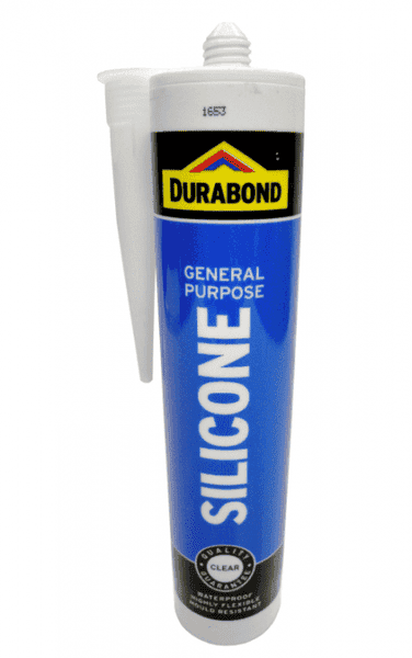

Also do you think olive oil is a good insulator? I can't get my hands on transformer oil like my supervisor did when she was building her tesla coil, but i heard olive oil can be used. I plan to sold the capacitors, then put them in a PVC pipe and insulate them with olive oil.
looks good :smile:
corruptdna said:
Basically this is what i did. Not necessarily spherical balls but i was told not to just connect the legs but put a bit of soldering and make sure there were no sharp edges so as to make sure no corona discharge occurs.
yup, that's correct, less likely to have a corona with rounded surfaces, till you get to the really high voltages like from a
encasing them in silicone sealer would be good ... there's a dozen different brands
eg
Van de Graff generator etc where the voltage exceeds 100kV or soDave
I was told to make sure the capacitors should be able to handle up to 140kv thus the need of making two legs of 18 capacitors. otherwise i wanted to use 8, 10/8=1.25 and that would only require one leg and make things easier, but that would also mean 8*10=80kv only. Thanks a lot for the replies dave, i will get to the soldering of capacitors then :)
You might check this thread for pictures of a commercial high voltage capacitor based device. They stacked the stages so the full voltage was not applied across any single part.
https://www.physicsforums.com/threa...asuring-things-etc.755959/page-5#post-5217555I don't have enough leftovers for your nine stages so can't help there
but i'd suggest you include high megohm voltage dividers to assure voltage divides about equally among your caps, and that they will self discharge after the machine is powered down.
Energy = ½CV2 , C = 1.25 X1 0--9 and V = 1.4 X105 , gives ~12 Joules , about the lowest range for defibrillators.
doesn't sound lethal but it'd sure be a jolt.
I'm cautious about silicone sealers, don't some of them produce acetic acid (corrosive) while curing? Need to research for one that is okay for potting electronics.
Trans oil is just mineral oil, available at the Hardware store. -- will be much better if you need to make changes / edits than permanent RTV Silicone -- You can use Denatured Alcohol to clean the oil off. You can get silicone oil - also used in transformers.
As for RTV there are two general types, one cures by UV, temp - etc, the other uses acid, which could be corrosive, but for a basic experiment I doubt it would be a problem.
If this is somthing you will handle often - you may want to "build in" a discharge resistor, to allow you an easy and convenient way to make the cap assy safe.
Since someone mentioned thins you can buy at hardware stores, you can also use liberal amounts of dielectric grease. Coat your connections and solder joints with dielectric grease to prevent unintentional arcing and coronal discharge. You can buy cans of it in the electrical section of hardware stores in the US.
