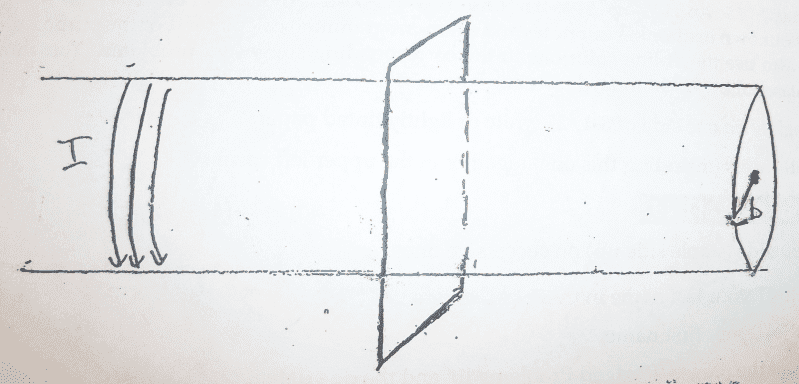

Solenoid Passing through square coil--Finding electric field
A very long solenoid with n turns of wire per unit length and radius b carries a current I(t) which decays with time as I(t)=I0e-t/T. The direction of current in the solenoid is as shown below. The solenoid passes through a single-turn square coil of wire with side length slightly larger than 2b and resistance R.
a) Determine the electric field both inside and outside the solenoid as the current is decaying. Provide both a magnitude and direction.
b) Determine the current through the square coil as a function of time, Ic(t) as the solenoid current decays.
c) Determine the total energy dissipated in the resistance of the square coil from over the time period t=0 to ∞. Where does the energy come from?
The induced emf can be obtained from Faraday’s law as
∫ E dr = -d/dt ∫B dA for an open surface S
I'm going to start with part a
If we let c=dB/dt, the rate of change of the magnetic field
We choose that surface to be a circle of radius r, and we note by symmetry that the electric field must be tangential to it so for r<=R,
Ein2PiR=cPir2
So Ein=1/2cr tangential to the surface
Eout=2Pir=cPiR2
So Eout=cR2/2r tangential to the surface
I will go onto the next parts next but I'm unsure if this is the right way to find the electric field...
thanks in advance,
sweetdion
