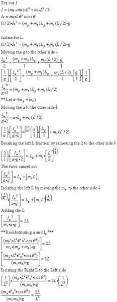

Solve 3 equations in three unknowns I, W, and L to find the critical value of L.
***Please See attachment 'differential.gif'****
also note, that I wrote all this using 'mathtype', if its of importance for any to know.
Please see attachment 'differential.gif'

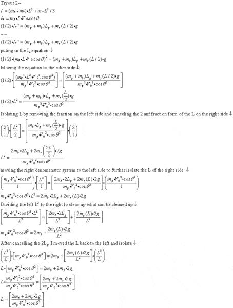

****Please see attachment 'Differential tryout.gif' and 'Differential Tryout2.gif'***
I squeezed my brain to what it can handle, but I can not understand how the textbook has got such a solution by its process which I do not understand------Please see attachment 'Differential textSolution.gif' ( since their is a max of three attachments, I am gona make a new thread named 'Differential Text sol' with the attachment.
  • Text-based physics problem: cannon fires projectile of mass mp into pendulum bob of mass mb on rigid uniform rod of length L and mass mr; list of symbol definitions, moment of inertia I = (mb + mp)L^2 + mr L^2/3, conservation of angular momentum Iw = mp L V0 cos θ, and energy conservation (1/2) I w^2 = (mb + mp) Lg + mr (L/2) g.
  • Handwritten-style typeset derivation of a critical length L from equations in I, W and L, steps include isolating L, substituting a = (m_f + m_s), and simplifying to 2L/(m_s g) = 2L.

  • Handwritten-style derivation of L = (2m_s + 2m_h + 2g) / (m_p Ψ_0^2 cos θ^2) by successive algebraic steps, with explanatory notes between lines.

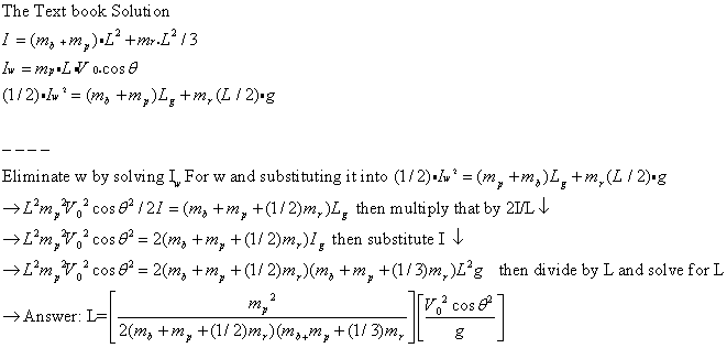

Differential text sol
see attachment in thread 'differential'
See attachment in thread 'Differential'
this has the text solution, which i do not understand how it got it?. Please see attachment "Differential text solution.gif'
  • Handwritten-style textbook solution showing three equations for I, Iw and (1/2)Iw^2, followed by steps eliminating w and solving for L, ending with L = [m_p^2 / (2(m_b+m_p+(1/2)m_r)(m_b+m_p+(1/3)m_r))] [V_0^2 cos θ^2 / g].
