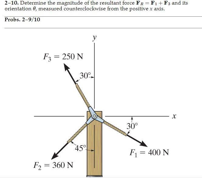

Solve for the sum of 3 cable forces on one anchor point

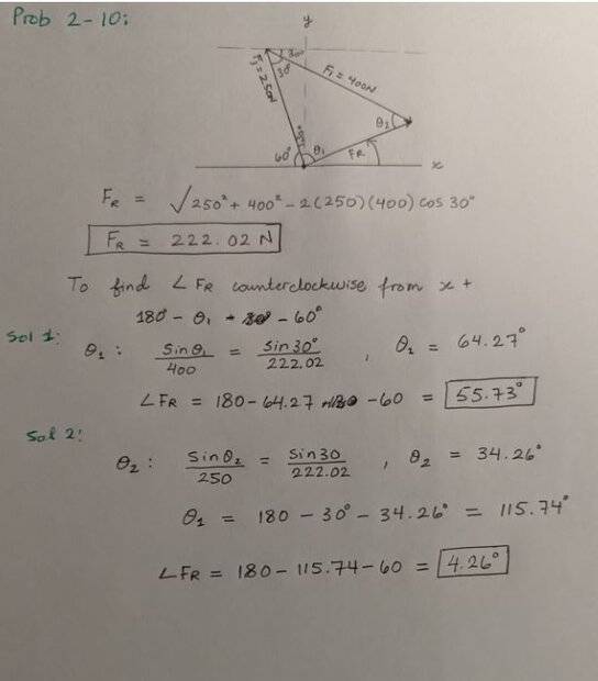

I solved this problem using two methods and my answer for the angle (Fr) is different for each solution. I am trying to figure out what I am doing wrong but I am stuck.
I know solution 2 is correct but why am I getting the incorrect angle when I use the sine law in sol1.
Please see attached for my work; any feedback will be greatly appreciated.
A/sina = B/sinb = C/sinc
What solutions are there to ##\sin(\theta)=x##?
Your calculation of ##\theta_1## is not correct; its value should be 115.74°.

Could you kindly explain how? When I plug the values in my calculator I get 64.27.
See post #2.
I am unable to explain how mathematically.
Please, see attachment, which may help you find the error.
