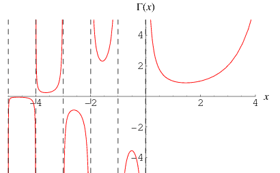

from the simple fact that \Gamma(z+1) = z\Gamma(z) where \Gamma(z) = \int_{0}^{+ \infty} t^{z-1} e^{-t} dt
Yeah, I knew it would settle down for Gamma function. If I got it then:
When to reparametrize r=r0t and calculate, we get the definition of Gamma function. Because in my problem, n was -1, I would have to calculate Gamma(-1). It's modulus is +infinity, because Gamma(n)= [Gamma(n+2)]/[n*(n+1)] and if n=-1, then we get division by zero and it's limit is infinity.

I think understand the divergence problem, quite simple actually. Integrating by parts gives Gamma(0), because one can show, that u*v limits to 0, so no recurrence relation for Gamma function needed at all, because modulus of Gamma(0) tends to infinity
PS! I was also right at the beginning. It can be also done by the upper incomplete Gamma function. Consider the formula:
What matters is on the right - I get the special case for upper incomplete gamma function (0,0) that in fact equals to Gamma(0) and this limit tends to infinity. At the same time this is also the special case for the lower incomplete gamma function, so they coincide for 0.
