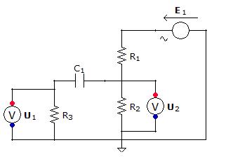

I have the following circuit...
I have managed to derive an equation for U2:
Now I want to substitute U2 into U1, in order to derive equation for U1
I have defined U1 as:
Now I substitute U2 into the above equation. This is how far I get...I am stuck...

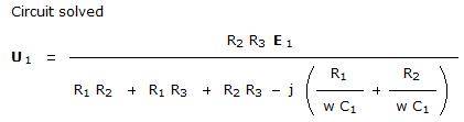

My circuit simulator is saying that U1 is equal to:
However I cannot simply to get this equation. Can someone please help I have spent hours trying to get U1 to look like the U1 that the simulator produces.
