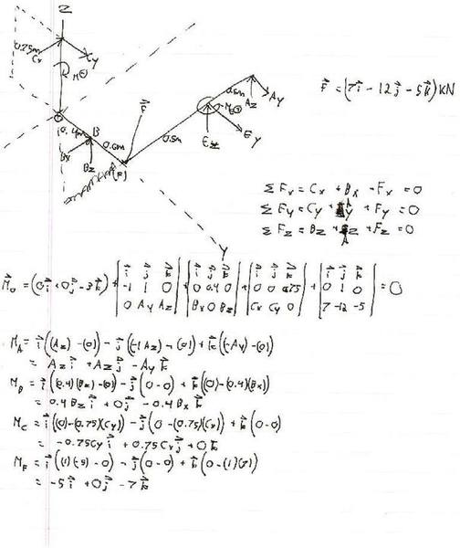

The question is asking for the internal forces at E, but I get stuck solving the external reactions. After that, I can do it, and have, using electronically generated results. I just get stuck solving the system of equations I get after doing the determinant equations.
We ignore the reactions at E. Those will be applied in the next step, where I find the internal forces there. I just drew them into help me remember where they are, and to visualize the problem.
The moment occurring between O and C has a magnitude of 300 kNm, and acts in the k direction.
Handwritten free-body diagram of a 3D structure with x, y, z axes, labelled reactions A, B, C, E and dimensions, followed by handwritten moment equations and a force vector F = (7i - 12j - 5k) kN.
[tex]\Sigma M_x = A_z + 0.4B_z - 0.75C_y - 5 = 0[/tex]
[tex]\Sigma M_y = A_z + 0.75C_x = 0[/tex]
[tex]\Sigma M_z = -A_y - 0.4B_x - 10 = 0[/tex]
[tex]\Sigma F_x = C_x + B_x + +7 = 0[/tex]
[tex]\Sigma F_y = C_y + A_y - 12 = 0[/tex]
[tex]\Sigma F_z = B_z + A_z - 5 = 0[/tex]
I tried it for two different unknowns, and both times it didn't work. Sorry for the poor images; I did the work in pencil, and it wouldn't scan very well.

Here are the real answers, and when I put my equations into a computer, it solves them and gets these. As such, I know my equations are correct. My problem just pops up when I try and solve for each unknown. If anyone could help me see where I went wrong, I'd be very grateful to them.

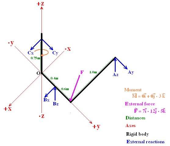

could you make a better draw vidatu? cause i as well have a lil problem reading your draw
3D free-body diagram of a bent rigid body with axes +X, +Y, +Z meeting at origin O, showing external reactions Cx, Cy, Az, Ay, Bx, Bz, applied force F, a moment, and distances 0.75m, 0.4m, 0.6m, 1.0m.
Hm. I had the arrows going the wrong way when I first uploaded this. All better now.
Hey Vidatu,
I can assure you that I had absolutely no intention of being snippy. If I made you feel bad, I’m sorry. Let’s forget all this.
And this diagram is fantastic.
No problem. I've had a long day of solving shear/moment diagrams, and should probably go to bed soon. I guess I'm not in the best of moods.
So, anyway, can anyone see where I messed up?
[tex] \bmatrix A_y \\ A_z \\ B_x \\ B_z \\ C_x \\ C_y \endbmatrix =<br /> \bmatrix -53.60 \\ 87.00 \\ 109.00 \\ -82.00 \\ -116.00 \\ 65.60 \endbmatrix<br /> \;\text{kN}[/tex]
Those solutions don't agree with the relevant equations. Look at the expressions for [itex]\sum F_y[/itex] and [itex]\sum F_z[/itex] with those numbers. Either these numbers or your equations are incorrect.
Um, yeah. That's because I messed up typing in the equations. I've fixed that now.
