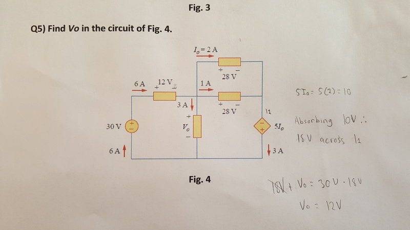

A screenshot with everything given
No idea
No idea
I'm not sure how to solve this or where to look for a solution. I was given this yesterday and have a test tomorrow. The professor has not gone over this at anytime, it's only the second week. Anything helpful would be great, even just what I need to google so I can attempt to solve this.
P.S. I do not know the solution.

Thanks for the help, would someone mind checking this for me as I don't know the answer.

That's not correct. Which current is I1?
How about you just consider the lefmost loop containing the 30V source? Apply KVL in that loop only.
Likes CWatters and scottdave
What is this 18 volts across I1 ? Try a loop around the lower left-hand square of circuitry.
Likes CWatters
If you draw the schematic in this way you may calculate ia and ib as function of Vo and then Vo=18 V.
[5Io=5*2=10V]
It's easier than that. No need to calculate ib at all. Just apply KVL to the left hand loop.
Likes Babadag and cnh1995

It is a very easy question..One needs to apply KVL around the loop with the 30 V source and 12 V component.
KVL simply states that the sum of voltages around a closed loop is equal to zero. Equivalently, sum of voltage drops is equal to sum of voltage rises around the loop.
As a side note, please know that any device in circuit analysis is a model. Two terminal devices are models/abstractions, for which the:
1. Current entering any terminal is defined.
2. Voltage function between the positive and negative terminal can be defined.
We arrive at these models through the lumped circuit abstraction, please google it if you would like to know more. Anant Agarwals lectures on MIT Opencourseware nicely cover it. This is if you want a good introduction to circuit analysis and basic electronics:
So, you have the voltage functions for two devices, you know KVL, you simply must apply this law around this loop and find ## V_{0} ##
We can use a simple equation here, but usually when going around in a "loop" I learned to check the polarity of the terminal through which the current I am tracking is entering, and assign this same coefficient to the voltage function, keeping this convention consistent is important.
So if we start from the battery:
## - 30 V + 12 V + V_{0} = 0 ##
## -18 V = -V_{0} ##
## V_{0} = 18 V##
