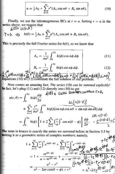

I don't know how to come up with this final solution:
[tex]1+\sum_{n=1}^{\infty}\left(\frac{r}{a}\right)^n e^{jn(\theta-\phi)}+\sum_{n=1}^{\infty}\left(\frac{r}{a}\right)^n e^{-jn(\theta-\phi)}=1+\frac{re^{j(\theta-\phi)}}{a-re^{j(\theta-\phi)}}+\frac{re^{-j(\theta-\phi)}}{a-re^{-j(\theta-\phi)}}=\frac{a^2-r^2}{a^2-2at\cos(\theta-\phi)+r^2}[/tex]
For [itex]\sum_{n=1}^{\infty}\left(\frac{r}{a}\right)^n e^{jn(\theta-\phi)}[/itex], multiply by [itex]\frac{a-re^{j(\theta-\phi)}}{a-re^{j(\theta-\phi)}}[/itex]
[tex]\sum_{n=1}^{\infty}\left(\frac{r}{a}\right)^n e^{jn(\theta-\phi)}(a-re^{j(\theta-\phi)})[/tex]
[tex]=\frac{ar^n e^{jn(\theta-\phi)}}{a^n}-\frac{r^{n+1}e^{j(n+1)(\theta-\phi)}}{a^n}+\frac{ar^{n-1} e^{j(n-1)(\theta-\phi)}}{a^{n-1}}-\frac{r^{n}e^{j(n(\theta-\phi)}}{a^{n-1}}\cdot \cdot \cdot \cdot\cdot \cdot+\frac{are^{j(\theta-\phi)}}{a}-\frac{r^2e^{j2(\theta-\phi)}}{a}[/tex]
[tex]=re^{j(\theta-\phi)}-\frac{r^{n+1}e^{j(n+1)(\theta-\phi)}}{a^n}[/tex]
[tex]\Rightarrow\;\sum_{n=1}^{\infty}\left(\frac{r}{a}\right)^n e^{jn(\theta-\phi)}=\frac{re^{j(\theta-\phi)}-\frac{r^{n+1}e^{j(n+1)(\theta-\phi)}}{a^n}}{a-re^{j(\theta-\phi)}}[/tex]
The same steps are use:
[tex]\Rightarrow\;\sum_{n=1}^{\infty}\left(\frac{r}{a}\right)^n e^{-jn(\theta-\phi)}=\frac{re^{-j(\theta-\phi)}-\frac{r^{n+1}e^{-j(n+1)(\theta-\phi)}}{a^n}}{a-re^{-j(\theta-\phi)}}[/tex]I expand the series out. You can see most cancel each other and leaving only two terms which factored out into 4 simpler terms. You can see two of the terms match the answer:
[tex]1+\sum_{n=1}^{\infty}\left(\frac{r}{a}\right)^n e^{jn(\theta-\phi)}+\sum_{n=1}^{\infty}\left(\frac{r}{a}\right)^n e^{-jn(\theta-\phi)}=1+\frac{re^{j(\theta-\phi)}}{a-re^{j(\theta-\phi)}}-\frac{\frac{r^{n+1}e^{j(n+1)(\theta-\phi)}}{a^n}} {a-re^{j(\theta-\phi)}} +\frac{re^{-j(\theta-\phi)}}{a-re^{-j(\theta-\phi)}}-\frac{\frac{r^{n+1}e^{-j(n+1)(\theta-\phi)}}{a^n}} {a-re^{-j(\theta-\phi)}}[/tex]
Compare with [itex]1+\sum_{n=1}^{\infty}\left(\frac{r}{a}\right)^n e^{jn(\theta-\phi)}+\sum_{n=1}^{\infty}\left(\frac{r}{a}\right)^n e^{-jn(\theta-\phi)}=1+\frac{re^{j(\theta-\phi)}}{a-re^{j(\theta-\phi)}}+\frac{re^{-j(\theta-\phi)}}{a-re^{-j(\theta-\phi)}}[/itex]
[tex]\Rightarrow\;\frac{\frac{r^{n+1}e^{j(n+1)(\theta-\phi)}}{a^n}} {a-re^{j(\theta-\phi)}}+\frac{\frac{r^{n+1}e^{-j(n+1)(\theta-\phi)}}{a^n}} {a-re^{-j(\theta-\phi)}}=0[/tex]
I have no idea how to make this zero, please help.
Thanks

This is part of the derivation of Laplace equation on a disk. The books show these three steps. I am trying to verify this by deriving from beginning to the end. The important thing is the boundary of the disk is ##r=a##. So the solution has to be finite when ##r=a## which rules out the easy solution of the few suggestions above.
It is given by the book:
This is my attempt:
[tex]=\frac{r^n e^{jn(\theta-\phi)}}{a^{n-1}}+\frac{r^{n-1} e^{j(n-1)(\theta-\phi)}}{a^{n-2}}+\frac{r^{n-2} e^{j(n-2)(\theta-\phi)}}{a^{n-3}}\cdot \cdot \cdot \cdot\cdot \cdot+\frac{r^2e^{j2(\theta-\phi)}}{a}+re^{j(\theta-\phi)}[/tex]
[tex]-\frac{r^{n+1}e^{j(n+1)(\theta-\phi)}}{a^n}-\frac{r^{n}e^{j(n(\theta-\phi)}}{a^{n-1}}-\frac{r^{n-1}e^{j(n-1)(\theta-\phi)}}{a^{n-2}}\cdot \cdot \cdot \cdot\cdot \cdot-\frac{r^3e^{-j3(\theta-\phi)}}{a^2}-\frac{r^2e^{j2(\theta-\phi)}}{a}[/tex]
As you can see, all except two terms get canceled out giving:

I cannot figure out what you are trying to do, but it does seem you are making the problem 100 times more difficult than it is. You want to evaluate
[tex]1+\sum_{n=1}^{\infty}\left(\frac{r}{a}\right)^n e^{jn(\theta-\phi)}+\sum_{n=1}^{\infty}\left(\frac{r}{a}\right)^n e^{-jn(\theta-\phi)}<br /> = 1 + 2\, \text{Re}\left[ \sum_{n=1}^{\infty}\left(\frac{r}{a}\right)^n e^{jn(\theta-\phi)} \right][/tex]
The summation can be easily computed using
[tex]\sum_{n=1}^{\infty} x^n = \frac{x}{1-x}, \;\; x = (r/a)\, e^{j(\theta-\phi)}.[/tex]

Yes, you are correct, but this formula cannot accommodate when ##r=a##. This is a Laplace equation on a disk where boundary condition is ##r=a##. So this formula cannot be used.
So what? It can be used for all r < a, so you get a formula that is 100% correct for r < a. It is a separate issue altogether whether or not you can extend the answer to the case r = a. If you cannot, your beginning formulation must either be (i) applicable only to r < a; or (ii) in error somehow. There are separate issues that you are confounding, and that is leading to confusion on your part, or so it seems.
Anyway, if you do what I suggested you will get exactly what the book says. If you don't agree with the method and the answer, you are saying that you disagree with the book as well.

I know I can pull out ##\frac {r^{n+1}}{a^n}##. But that does not help to make the whole thing to zero.
It is NOT zero, and there is no reason why it should be. All you need is

No I did not forget, I need to have the formula work for ##r=a##. This is the solution of Laplace with boundary condition at ##r=a##. You cannot say the OP was wrong from the book and only look at ##r<a##. Solution has to be continuous at the boundary.
Also, the method in the OP was suggested by the book. I just cannot cancel it out.
This is the copy of the book, it's for Laplace on a disk ##r=a## with boundary condition. Please ignore my writing.
166217[/ATTACH]"]

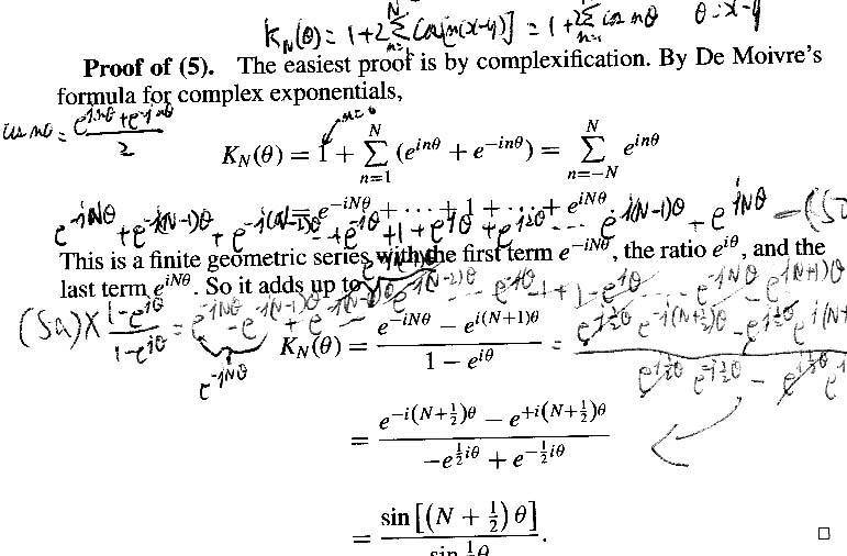

The method the book referred to in section 5.5 is as follow:
166219[/ATTACH]"]
166221[/ATTACH]"]
