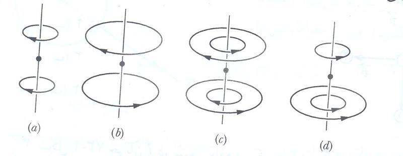

Hello
1-here is a problem that want to specify which current loop has max electromagnetic intensity?(the correct choice is d)
(Loop radius: small loop (r) big loop(2r))
so i think choice C is correct it because of this result
and
do i think correct or not?

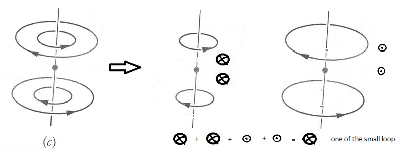

I try to explain more about choice 'c'
we separate choice 'c' and do Spperpostition.

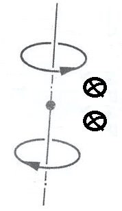

the MF of two small loop is going into page(am I right?)
so it increase amount of MF intensity(B1+B2)

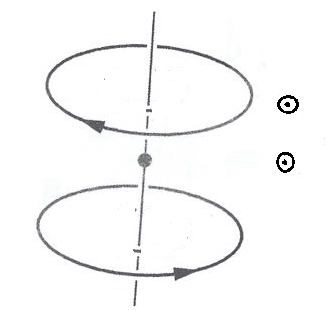

and the MF of two large loop is going out of page(am I right?)
(B3+B4)
as we know the amount of B3 and B4 is smaller than B1 and B2 it because of their loop radius
(radius of big loops is 2r and radius of small loops is r) so B1+B2 can remove the effect of large loops and remain some MF into page direction(am I right).
if we assume r=1 and 2r=2 we have(we ignore constants(m0/2))
B1=1/1
B2=1/1
B'=B1+B2=2(into page)
B3=1/2
B4=1/2
B''=B3+B4=1(out of page)
BT=B'-B''=1(into page)

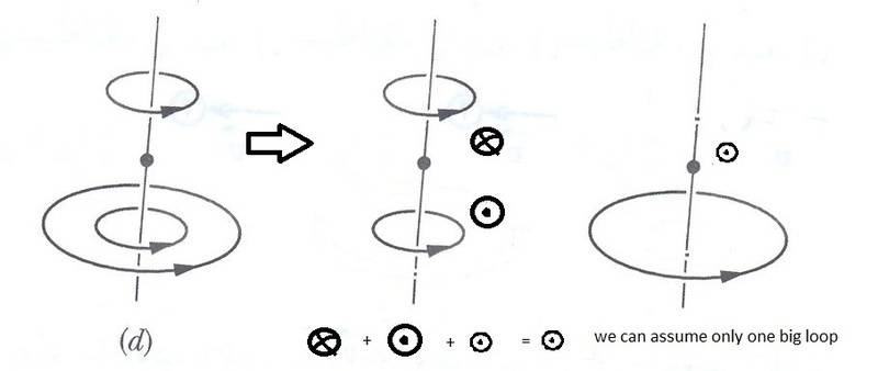

now for choice 'd' we can do same approach
B1=1/1(into page)
B2=1/1(out of page)
B'=0
B3(large loop)=1/2
Bt=1/2
so choice 'c' is bigger than choice 'd'
Rather than thinking in terms of into or out of the page, think like, up or down the axis. Every picture shows an axis right? And you are asked to probably find in which choice the field has greatest intensity at the point indicated as a thick dot on the axis.

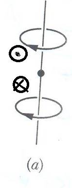

See (a): both currents are turning clockwise. So the field is added.
See (b): the upper current flows clockwise whereas the bottom one anticlockwise. So the magnetic fields are opposite and cancel out.
See (c): the two small currents are opposite and their magnetic fields cancel. Similarily the two bigger currents are opposite and their magnetic fields cancel.
See (d): both of the small currents are in anticlockwise direction and their fields add up. Plus the large current flows in same direction too! Hence all the three add up!
