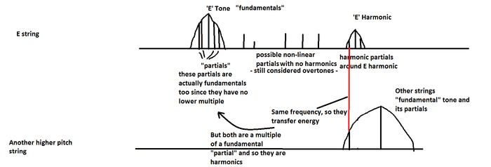

Ok, maybe this will help clear things up, or make it more confusing . . I'm not sure.
http://en.wikipedia.org/wiki/Harmon..._fundamental.2C_inharmonicity.2C_and_overtoneI think, when I say fundamental I have been meaning partial with no lower multiple of itself (which is implied as a fundamental by the wikipedia article), as in a mode of vibration that has no multiple lower than it. If you see the way things are defined, overtone is a broad and general definition of all partials.
Every time I have said "mode of vibration" I have been referring to a partial. One string can only transfer energy to another string if they share a common frequency to transfer the energy. A partial of a lower string can have a higher multiple partial, and if another string shares that same higher multiple partial, it will vibrate. They are called harmonic partials. A harmonic partial is any collection of partials that share a common frequency - a fundamental.
An overtone is ANY partial, and so an overtone may or may not cause another string to vibrate. A harmonic partial will always cause the other partials of the common fundamental to vibrate. This is the distinction I've tried to make of why overtone is not the correct vocabulary to describe the answer to OP's question.
As an example, say a person plucks the lowest E string and it vibrates at the E tone, but also with its overtones - partials around that E - and then also the harmonics of the E and all those partials, which means you will have a harmonic of E and harmonics of all its partials that have harmonics. If another, higher pitch string, has a partial equal to the frequency of one of the E string's partial's harmonics, it will vibrate.

Here is a drawing to describe what I am saying:
Fine, according to your personal definition. Just don't expect others to understand you.
Not my personal definition- my interpretation of the article.
Just let me wrap this up: Two strings will only vibrate if they share a common frequency. For those frequencies to be common, they must be multiples of each other (n = '1') and so are harmonics. If a higher pitch string has a common frequency to a partial of a lower pitch string, then that partial of the lower string is either a fundamental or a harmonic of a fundamental, and so the frequency is a harmonic.
The only way for a frequency to not transfer to another string is if that frequency is exclusive to that string, and so it IS NOT necessarily a harmonic, it IS still a partial, and it IS still an overtone. Please don't be so condescending when it is obvious that only frequencies shared by both strings, harmonics, are the only ones that transfer energy, while an overtone can refer to any frequency generated that isn't necessarily common between 2 strings.
Ok, I didn't see the drawing at first. I thought you meant something else, like considering a frequency 5.1 times the fundamental as a new fundamental.
Can you quantify how wide that frequency range is? I mean the "fundamental" frequency range. There's a lot of causes for having more than one single lowest frequency (string tension changing while the vibration is damped, attack noise, unavoidable indeterminacy for very short notes, etc.), but I think none of these allows to define more than one fundamental. So, how wide is it? Does it change over time? How wide is it during the "decay" phase of the note?
And by the way, the overtones which are not harmonics that we were talking about have nothing to do with your drawing!
