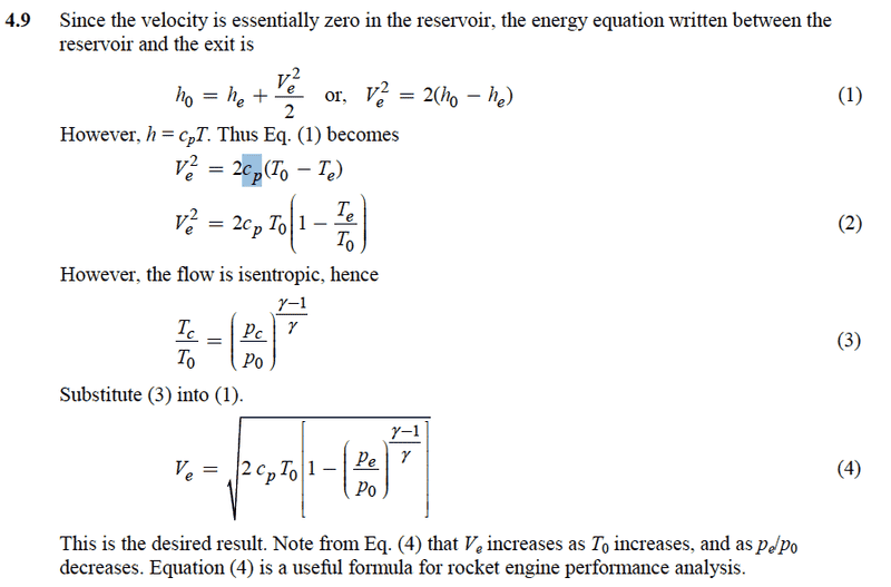

In this question, the pressure is different at different point, in other words it is not constant throughout the system. Why the solution use c(p) (or "enthalpy" h which specified for constant pressure system) as part of the formula used?

For an ideal gas, enthalpy is independent of pressure. Doesn't the open system version of the first law require you to use enthalpy?

Is that imply enthalpy is used just because the first law of thermodynamics is applicable?
And using Cp is not contradict to the situation of pressure changed, but rather Cp is used because it can trace out the enthalpy?

Yes. The open system version of the first law tells us that, for your problem the change in enthalpy is equal to the change in kinetic energy.

Yes.
