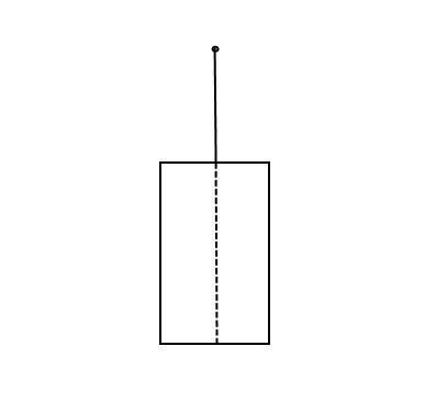

A (rectangular homogeneous) picture is hung with a nail on the wall from a twine. Neglecting the friction of the twine with the nail and that of the wall with the picture,
a.-Could there exist equilibrium in other positions than the one where the picture is hanging horizontally? If so, are those other positions in stable equilibrium?
b.-Is the picture in stable equilibrium when hanging horizontally?
Thanks for any help
I´m attaching a drawing

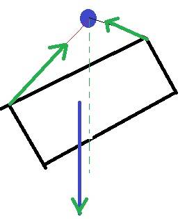

Torques about a point.
I chose the nail as reference. Tensions are going at an angle but their line of action intersect at the nail so only the weight could make any torque about that point. Horizontally there{s no torque at all about that point. If I slightly tilt the picture then a torque appears about that point trying to restore it to its original horizontal position. sO I think QUESTION b is: YES.
Part a. I think it´s more tricky... I{m not sure about the geometry. I´m trying to see if having different lengths for the two sides of the twine make it impossible to vanish the torque generated by the weight.

What does your intuition tell you? Suppose the center of the twine slides sideways by even the slightest amount relative to the frictionless nail? Can this represent a stable configuration for any possible rotational orientation of the picture? If the sliding continues, where will picture end up?
Yes, my intuition tells me it will continue slipping to one side if not adjusted horizontally. But when I make a Diagram it seems to depend on the length of the picture frame. :s
For a very rectangular frame it seems that the picture will have a net torque about the nail the will keep making it rotate to the same side, I drew something...
Can somebody confirm my diagram is right in telling me that this will be unstable because of the torque made bythe weight?

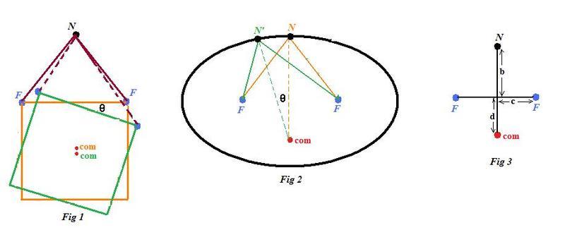

The string has a fixed length and the ends are attached to fixed points of the picture. So, an ellipse might be relevant. See attachment.
The points of attachment are the focal points of the ellipse (fig. 2). Here I picked the attachment points at the top corners, but that isn't necessary. If the picture is tilted as shown in fig. 1 then that corresponds to moving the nail from point N to N' on the ellipse and then rotating the entire ellipse clockwise by θ until the line from the COM to N' is vertical and shifting up or down until the nail is in its original place. If the distance N' to COM is greater than the distance from N to COM, then the COM shifts downward (as in fig. 1).
Whether or not the horizontal position of the picture is stable equilibrium depends on the relative sizes of the quantities shown in fig. 3. If the horizontal orientation is not stable, then you can find an angle of tilt where the picture is in stable equilibrium.

Oh thanks! I think I did enough research for this problem! I'll try to access a full version of the paper. I'll contact my teacher about this because it seems it's not a straightforward problem and it involves many more details. Thanks
