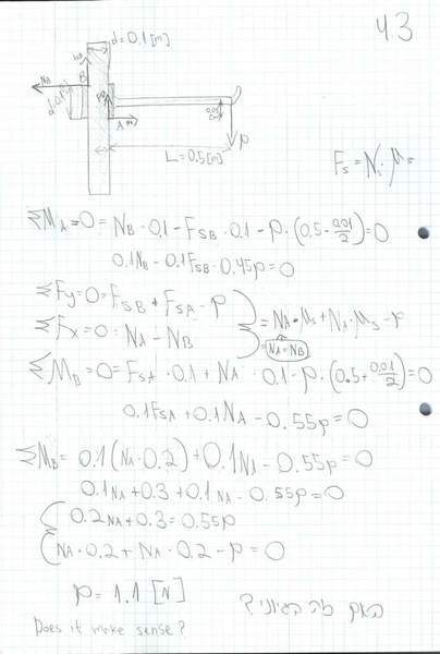

Static friction is my answer correct?
4 replies · 2K views · last reply
Femme_physics
2,548
What's the max weight, P, you can hang on the hanger's arm, when the hanger arm is attached to a pole with the help of two friction forces at point A and B.
http://img543.imageshack.us/img543/8466/maxwqeight.jpg
Static friction coeffecient = 0.2
L = 0.5 [m]
d = 0.1 [m]
Attached here... I didn't use all the equations but I wrote them anyway
Dory: Nice work. Your current answer is incorrect. Hint 1: By symmetry, Fsb = Fsa. Now you have three unknowns, and three equations. Hint 2: Fs does not necessarily equal mus*N. Try again.
Thanks for replying, nvn! I was actually told by my lecturer yesterday that this question is actualy super hard since there is an angle between to two Na's and he's only going to teach it after kinematics...from some reason he decided to put it in the exercise book to "challenge us" but he never told us it's super hard and takes a lot of thought... I personally thought it seems easy and can be solved with basic static rules... but I guess I'm wrong?.
Femme_physics: You are right; it is solved with statics.
Ah...then peculiar why would he say it's so complicated when it's not. I'll try again later.
