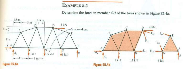

see attachment
Why is DG, DE in tension while HG is in compression according to the FBD? How did the book determine this? Do you just randomly guess tension/compression and then do the calculations and see if you get a positive/negative number? Is there a set procedure? Thanks.

It's ok to make assumptions, consistent with Newtons 3rd law, but limit the number of assumptions you make or else the plus and minus sign will devour you. I notice that the solution shows Ax pointing right, when obviously it must point left, so don't assume when you don't have to. Always calculate support reactions first, numerically, that's a big help. When you look at the right side cut section, since R points up, producing ccw moment about G, then Fde must point inward toward the joint, to produce a cw moment about G . Fde is compression by the way, since it points toward joint . Forces pulling away from joint are tensile.
