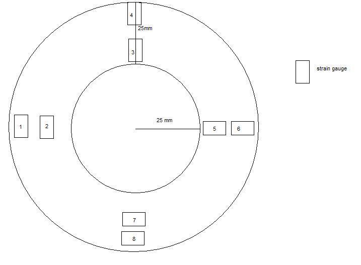

The discussion focuses on measuring radial and hoop strain in an aluminum cylinder using a full Wheatstone bridge setup. The user seeks advice on optimizing strain gauge placement to ensure accurate measurements, particularly in a shrink-fit system. Concerns include the difficulty of compensating for strain gradients at the boundary between the surfaces. The user has not yet tested their current setup due to limited materials and a desire for confidence in its effectiveness. Constructive feedback on the proposed configuration is requested to improve measurement accuracy.

1. Problem Statement: I am trying to measure the radial (#s 3-6) and hoop (#s 1, 2, 7, 8) strain (and from that, stress) present in an aluminum cylinder. I am trying to use a standard full wheatstone bridge setup, but am having trouble settling on a setup that would give me an accurate measurement. I haven't tried my current setup yet as I want to be reasonably sure that it will work before using my given materials since they are relatively limited. Can anyone offer any constructive criticism or help?
2. Homework Equations : N/A
3. The Attempt at a Solution : see attached picture

Also, I forgot to mention that the cylindrical system is a shrink-fit system, with dimensions as shown in the picture. One of my main problems is trying to compensate for the gradient imposed by the boundary between the surfaces.
