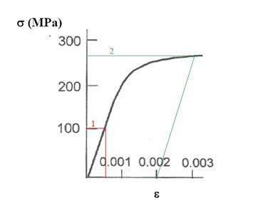

for 1) i assume that the red line is meant to be at 0.0005 therefore
E=dσ/dε=100e6/0.0005
E=200Gpa
for 2) i don't know what i can do, all that i do know is that the slant of the line from ε=0.002 to the point of σy is equal to 200Gpa (from the E i found before), but how can i use this to find the stress, i do not know the strain for σy, since i was given the nuclesu size i think i must somehow use that, but how??
Ignore the 100 micron nucleus info. The sample yields where there is a deviation from a linear stress/strain relationship, right?
but how can i use that information, when you say a deviation from stress strain relationship, do you mean a deviation from the young modulus? i don't think that that's true, is there not a small portion where the line is not linear but before yielding?
even on the graph there is a portion between the linear section and the point marked as 2 with the green line
i think i need to use the imaginary linear line that starts at 0.2% and rises to yielding stress at a slant equal to E
Agreed.
now i assume that the apropriate strain for the yielding stress is 0.003, is that correct?
σ/0.001=E=200Gpa
σ=200MPa
is this correct? according to the graph it cannot be
It's simpler than that. The convention is to use the stress where the 0.2% offset line meets the actual stress-strain curve.
but i don't know the function of the actual curve, do you mean the linear section,
where
σ=200Gpa*ε
(ε=0.002)
σ=400MPa
dont think that's what you mean,
how can i find the curve after the linear section?
You read it off by eye.
is there no way to calculate it?
