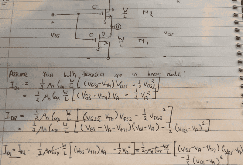

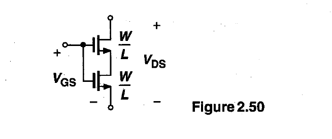

I think that up there is right so far since I didn't see any other relationship between the two MOSFETS other than their IDs are equal. But after I keep simplifying that equality, I end up with this
I have no idea what to do with this now.
