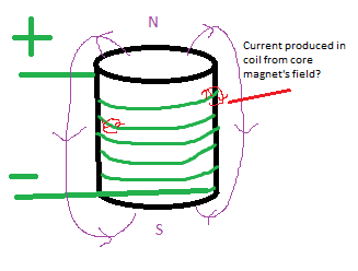

Post #19 is what I considered to be the answer I was looking for- here's how I interpreted it:
- As a permanent magnet, the material has more up electrons than down so there is potential for an overall magnetic field.
- As per the description in http://farside.ph.utexas.edu/teaching/302l/lectures/node77.html (figure 30), when influenced by an external field the electrons can line up in generally the same way to produce the overall pseudo-current (due to electrons acting the same way) around the perimeter
- This does not make up a complete current circuit, but at the same time there is still current in each atom due to the electrons lining up the same way. Because of this there would (if I'm understanding this right) still be an extremely small current.
- Because there is (albeit an extremely small) current, in theory it would induce a very small current in a coil going round the outside (due to the magnetic field from the magnet)
I think I got the positive and negatives the right way round this time!
So what the image is trying to show is a small magnetic field would be induced in the coil from the big magnetic field... This is what I have been wondering all this time and from what I've seen I thought this was the case (but on such a small scale it would barely be measurable)
...Have I understood that right?

The magnetic surface currents are quite large. A solenoidal current of 1 ampere with 500 turns(=wire windings) per meter, results in a solenoidal current per unit length of ## K=500 ## amperes/meter. The magnetic surface currents (current per unit length ## K_m ##) in an electromagnet and/or a permanent magnet are much larger and can easily be 1000 x this number. And that is why an electromagnet which consists of a solenoid (wire windings carrying a current), plus an iron core will generate a magnetic field that can be 1000 x as strong as the magnetic field from the solenoid without the iron core. ## \\ ## The magnetic surface currents are of a similar strength in a permanent magnet. The stronger the magnetic field, the higher the magnetic surface current number for the same geometry. In principle, it is the magnetic surface currents that generate the magnetic field in an electromagnet and/or permanent magnet.

@atommo You have 'liked' the post with this quote in it but you do not seem to be taking its message on board. For heaven's sake get yourself familiar with the basic theory of permanent magnetism before you reach for 'fringe' treatments of it. How can you expect to grasp it without learning the basics?
