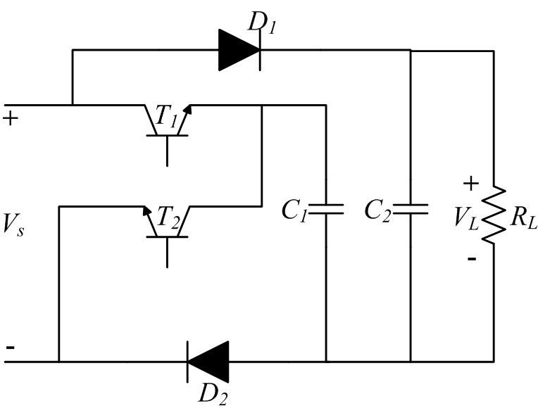

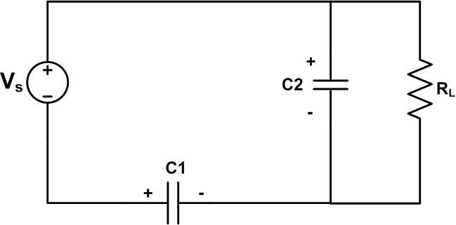

Plz guide how I can solve below circuit i.e. its transient analysis..final expression for load voltage..it is actually mode 3 of my capacitor based boost converter ..in mode 3 T2 transistor on while T1 off..so output would be double..I need expression for instantenous

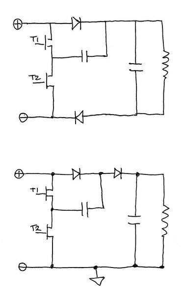

You can redraw your circuit to give a common ground reference. See attached.
First change C1 to connect with the positive side of the load.
Then move the series diode D2 to the positive side of the load.
You now have a common ground reference with a charge pump that is easier to analyse.
Can you now analyse the charge pump circuit ?
If you still have problems, ask further questions.
