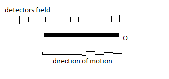

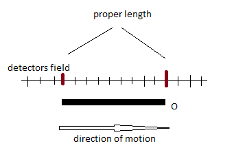

So, on the 1st page I was arguing that the way the measurements are taken, probably would matter!
The way @PeroK setup the measurements is very convenient for what I was thinking.
I would have a series of detectors that would record the time the front of the object and the rear of the object pass. We could assume that the detectors are 0.1m apart, say.

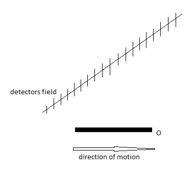

In case that the detectors are at a distance of 5 mm away from the object passing by them, wouldn't them register the length of the object as being actually the proper length of the object?
Wouldn't the distance between the detectors and the traveling object affect the measured length (or the length contraction for that matter)? Like in, the further away the detectors are from the traveling object, the grater the discrepancy between proper length and measured length would get?
Let's say that we have the following disposition for the detectors relative to the direction of motion:
Setup A: length contraction detectors field 1.1.png
Setup B: length contraction detectors field 1.2.png
Would those two different scenarios measure the same length for object O, traveling at .9c, relative to the detectors?
P.S. the distance between the detectors is equal, relative to direction of movement of object O.
