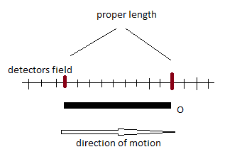

  • #72
@A.T. , I'm thinking that height contraction would still allow the object to fit through the narrow hole.
@jbriggs444 , so you say it's not a physical modification. Here I was a bit confused since reading some of the posts I thought it implied an actual physical change. An idea which I'm not very comfortable with, either. If I understand correctly you say that this implies a mathematical transformation, a change of basis from one coordinate system to another. So, you are talking about a mathematical model to described the phenomena.
Somehow I get the sense that you and @PeroK don't agree on this either or is just my fracture here?
@m4r35n357 in that case, considering the following experiment I stated above:
If I take @Nugatory detectors array setup (garage door example) further, to perform the measurements:
So, the object (traveling at 0.9c relative to the sensors array) has detectors on both ends. In that case, we measure the distance between two sensors which detect both object's ends at the same time. In this case, should I expect the distance between those two sensors to be, the proper length of the object ?
- because, this would be more of a snapshot than a "smear over time"? (length contraction detectors field 1.3.png)

  • #73
What about the frame of the object, where the hole is contracted, not the object?
  • #74
If it is not a "smear over time", then there is no "length contraction".
[EDIT] and that is as good a definition of "loss of simultaneity" as I can give!
  • #75

  • #76
@jbriggs444 got it, nothing physical is being modified.
@m4r35n357 I would like to know how you settle the "smeared over time" matter with @A.T. since to me, it seems that you have different understandings of the matter.
@PeroK , @A.T. or anyone else for that matter, what is your take on this variation of the experiment, what would be the measured length?

  • #77
No idea if it's different because "smeared over time" is completely vague, and might mean anything.
Do you understand why you cannot have length contraction perpendicular to velocity (see post #73)?
  • #78

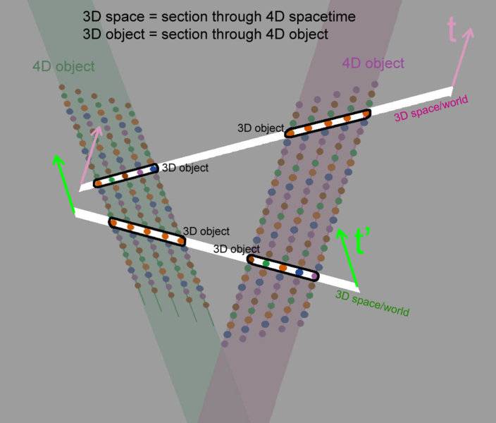

If you measure the cross-section of a cylinder, it is a circle with some diameter d. If you tip the cylinder over by an angle ##\theta##, the horizontal cross-section becomes an ellipse with minor diameter d and major diameter ##d/\cos\theta##.
This is closely analogous to length contraction. What we call a 3d object is a 3d section through a 4d worldtube. In a frame where the object is at rest we've defined its worldtube as perpendicular to what we're calling "space". In a frame where the object is moving, we've defined its worldtube as non-perpendicular to what we're now calling space. So the purely spatial cross-section of the object has changed. Just like the cross-section of the cylinder, nothing has happened to the worldtube. We've just picked a different cross-section to call "the 3d object" (but hyperbolic geometry means that you get length contraction, not expansion as in the Euclidean analogy of the cylinder).
So nothing happens to the object. Length contraction is a misnomer in this view - rather, we're changing what we call "the length of the object".
  • #83
This is an astonishingly eye-opening explanation of length contraction!

Well, but I guess @Ibix's last comment cleared things out for me.
Ibix said:
nothing has happened to the worldtube. We've just picked a different cross-section to call "the 3d object".
This is what I was not understanding actually, the physical change of the object length. No I get it, it's not an actual physical length change but a measurement of length in a different system of coordinates. A transformation applied to the mathematical model which reads different values from a different points of view.
That's great, so the physical properties of the object remain unchanged no matter what the speed. This is perfectly acceptable.

...I see no reason as to why the detectors would measure anything else but the proper length ...
The detectors don't measure length directly. You need synchronized clocks at each detector to compute the length. The contracted length comes from using clocks synchronized in rest frame of the detectors.

Still, reverting back to what @Nugatory said earlier, shouldn't a real world array of detectors like the ones that he described, register the proper length for the moving object?
At least, I see no reason as to why the detectors would measure anything else but the proper length in any situation (since the physical properties of the object remain unchanged no matter what the speed).

You are forgetting to take the relativity of simultaneity into account.
Detector A triggers when the front of the moving object reaches it.
Detector B triggers when the rear of the moving object clears it.
A and B are positioned so that, using the frame in which they are at rest and the object is moving, they both trigger at the same time. Because they both trigger at the same time we conclude that the length of the ship using this frame is equal to the distance between the detectors.
However, these two events do not happen at the same time when we use the frame in which the object is at rest and the detectors are moving. Using this frame the timestamps the detectors are recording do not agree with a clock that is at rest relative to the object and moving relative to the detectors, and when we use this clock we find that detector B triggers some time after detector A. During the time between these two events both detectors' beams are blocked by the ship, and we conclude that when we're using this frame the length of the ship is greater than the distance between the detectors. (Note also that when we use this frame the distance between the detectors is less than when we use the frame in which the detectors are at rest).
So no "physical change" but we still find different lengths.
