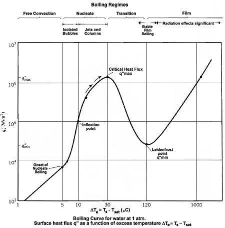

What determines the surface temperature inside a pot of boiling water, right over the heat source? Can it go much over boiling temp if the water's just gently boiling?

From intuition: As long as the surface is covered with water (no lingering/giant bubbles) then the surface should remain right at boiling temp.
From other sources: Heat Transfer Coefficient is involved somehow.
However, I'm interested in any phenomena that could influence the surface temperature, not just the ones I'm already considering.
You are correct: the temperature at the surface of boiling water must be nearly exactly the boiling temp.
What could I do to get my pot surface hotter than boiling temp? I've seen correlations for boiling heat transfer coefficient; do those only account for bubbles insulating boiling surfaces or other phenomena as well?

You mean the surface of the water? Nothing. Water cannot be liquid above its boiling temp.
I'm not sure what you are referring to. Could you explain?
Use pure water and a clean surface. In the absence of nucleation sites, water can be raised above its boiling temperature without boiling. Most commonly, this is seen when heating water in a microwave.
However, this goes counter to the description of the situation in post #1: "gently boiling".
Yarbles may be referring to the temperature of the shell of the heating vessel rather than the temperature of the water .
In that case answer to question is that the shell temperature could be much higher than the water temperature . It has to be higher to some degree anyway otherwise there would be no heat transfer .

Yes I'm interested in the temperature of the pot's surface and how much it can differ from boil temp.

I was referring to correlations that give a delta between boiling surface temp (the solid surface) and boil temp.

If I change the boiling temp will the boiling surface (is 'hot wall' a better term?) change by the same amount?

Which surface of the pot? It has two. One in contact with the water and one in contact with the flames/heating element.
Sorry to be unclear.
Inside surface or outside surface? The inside surface won't be much above boiling temp, but the outside surface can be.

To be clear from here on out:
I wish to know how much the temperature of the inside surface (solid surface that's in contact with the fluid) can differ from the current boiling temp of the fluid.
More importantly, I'm trying to understand the mechanisms that can cause the temperature difference.
See post #6. Ignoring the possibility of superheating, the inner pot surface cannot be hotter than boiling.

If I increase boiling point then won't the boiling surface increase in temperature until boiling begins again? At that point, if heat in (power of the burner) is unchanged then the rate of boiling (mass of steam created per second) should remain unchanged?
If you increase the temperature of the inner surface of the pan by (for instance, 1 degree) then the temperature of the outer surface of the pan will change as well. Possibly not by 1 degree but by some amount.
If you increase the temperature of the outer surface of the pan by some amount then the rate of heat transfer from the flames may change. Not by much, probably, but by some amount.
If you increase the boiling temperature by some mechanism, the latent heat involved in the transition from liquid to gas may also change.

The water and the inner pot surface are in contact. They must be at the same temperature or have an infinite rate of heat flow.
Why would we ignore the possibility of superheating?
Because the problem becomes much more difficult if we have to account for the number of nucleation sites that may or may not exist.
There is a boundary layer with a very steep temperature gradient between the pot inner surface and the bulk of the water .

Ah, I don't actually want to make the solid surface hotter but I'm interested in what could/would make it hotter than boiling temp. Temperature gradient through the thickness is not something I need to consider.
I appreciate your patience with my PF question (I'm assuming it doesn't stand for Perfectly Formed?). At the very least, trying to communicate what I'm trying to understand is forcing me to get things straight in my head.
Does the pot side of the boundary layer go above boiling temp? The microwaved super-heated water example above suggests this might be possible, maybe while the water waits to nucleate? (note I know next to nothing about nucleation)
Yes .
