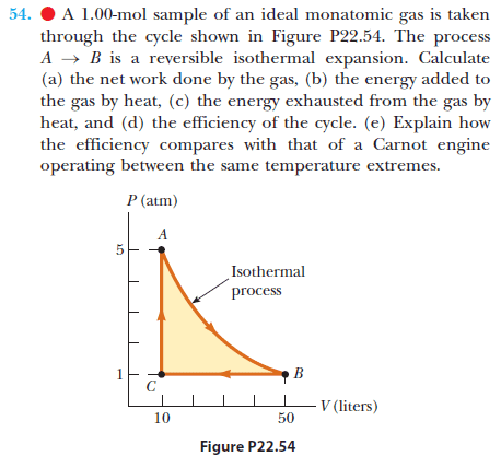

Thermodynamics - reversible isothermal cycle
Feodalherren
604
I can do everything else except work for part one going from A to B.
What I did was
-∫PdV = -nRT ∫(1/v)dV = -nRT ln (Vf/Vi)
I can solve for T because everything is given, T in Kelvin is 882.
From PV=nRT
T=(5atm)(10L)/1mol*R = 882K
where R = .0820582
Therefore w= -1mol * R * 882 * ln (5) = - 11.8kJ
where R = 8.314
But this is incorrect. It is supposed to be -8.15kJ
What I did was
From PV=nRT
T=(5atm)(10L)/(1mol*R) = 882K
where R = .0820582
Redo the calculation in red.
ehild
Hmm...
50 / (.0820582) = 609 K
Argh nevermind I thought it gave me the T in celsius! Thank you Ehild!
