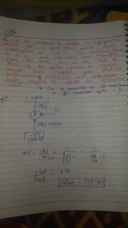

Thank you so much sir , I get it now , one final doubt , I'm attaching a picture, I don't want to know the solution of it , just tell me that what will be the ##Q_h## here , like the practical meaning of it , like ##Q_c## is the heat removed from refrigerator.
##Q_h## is the heat rejected to the room, and is equal to $$Q_h=Q_c+W=5\ kW + W$$
If you look under the refrigerator, you will see a set of tubular coils over which room air is blown by a fan to remove the heat. The heat transfer occurs at the room air temperature.
Correct me If I'm wrong ,
Lets say a refrigerator is working at 5 degree Celsius and we need it at 3 degree Celsius, so heat required to be removed to bring 5 to 3 degree Celsius is the ##Q_c## and for to remove this heat we have to do some work that's W so ##Q_c## + W is the ##Q_h## and this ##Q_h## is the one what we feel warm outside a refrigerator .
If you wanted to lower the temperature inside the refrigerator from 5 C to 3 C, you would have to increase ##Q_c## above 5 kw, and this would require a proportional increase in both W and in ##Q_h##. Regarding ##Q_h##, it is what you feel when you put your hand in the air stream coming from the outside coils.
