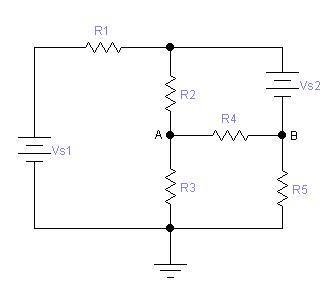

I want to find Rτ (Thevenin Equal Resistance) if the load is R4 in the attached image's circuit.
As easy it may seem, I get confused because it asks for the equal resistance between A and B.
We remove the voltage sources and s/c them. Then we have: R1 is parallel to (R2+R3) -> R1//(R2+R3).
R5 parallel to the rest. So we have in total: Rτ= [R1//(R2+R3)] // R5

Welcome to PF :smile:
I see no current sources in the figure, those are voltage sources. So, what do we do with voltage sources?
Also, note R2 & R3 are not actually in series. Because node A has a path leading to R4, they (R2 & R3) do not have an equal current going through them.
Sorry my mistake. I meant Voltage sources. I need to find the Thevenin Equivalent Resistance if i take R4 as the load. So I replace voltage sources with short-circuit and also remove the load R4. From this point could you help me figure out the connections of the resistors ?

Your approach looks ok. But the calculations are wrong. Check again how to calculate the paralleled resistances. Have you gotten ET already?

I haven't done any calculations yet, I just indicated how I think the resistors are connected. No I just want to find RT

I would redraw the figure (with voltage sources shorted), with "A" at the very top and "B" at the bottom. Redraw/move the resistors around until you see some that are in parallel or series, and combine them.

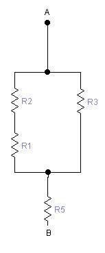

I came up with this one, but the equivalent is different than the first one i posted ( Rτ= [R1//(R2+R3)] // R5 )
In this case it is: RΤ=[(R1+R2)//R3 + R5]
Please give me any hint as I am very confused.

I'm not sure if this is any help to you, but what can be said about any open circuit (i.e. unconnected wires)?

There's some problems with your figure. Just for example, R2 should connect between A & B, after Vs2 is shorted.
