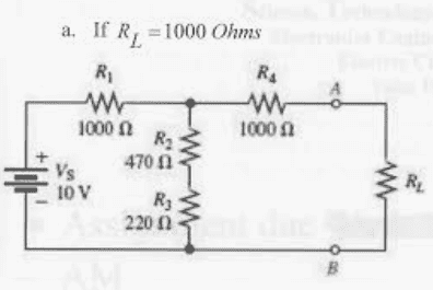

Thevenin resistance and Thevenin voltage confusion
theycallmevirgo
108
25
Use Thevenin Equivalent Circuit to find current through R_L
E_Th=open circuit voltage
R_Th=R_t looking into the circucit from the load

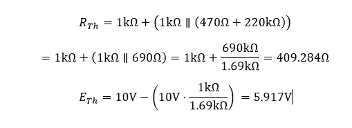

Your numerical expression for ##R_{Th}## is not correct. ##1000 \Omega \cdot 690 \Omega## is not ##690 k\Omega##. Ohms times Ohms is Ohms2.
Ok, but that should only throw me off by a power of 10. The simulation results aren't even close.
Well, your Thevenin resistance should be greater than 1000 Ω(since R4 is already 1000 Ω), right? So check your math.
