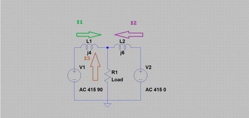

  • #31
The load power factor is said to be lagging which implies that the load impedance should have an inductive component (current lags voltage). That in turn implies that the angle associated with that impedance should be positive. So fix up your load impedance.
  • #32
Ah, damn it! That makes sense when you put it like that!
OK. I will re calculate using;
Z_L=50∠45.572°Ω
Thank you

The individual impedances of the components are already given. Take a close look at the circuit diagram that was provided in the first post.
  • #35
am I correct then at saying j4 and j6 are the impedances respectively? this equation is giving me a hard time haha they only show examples of thevenins theorem using resistors which I totally get but then they throw the odd ball like this and I am completely lost like the other chaps on here...
oh and you multiply j4&j6 to get j24?
  • #36
Yes. Those are the impedances of the two inductors.
The 'j' represents the square root of negative one. That is, the impedances are imaginary values (and are complex in general). So the arithmetic you do with them must follow the rules of complex arithmetic.

Hey Ebies,
As gneill has already said, "The 'j' represents the square root of negative one."
To help you get started, below is the calculations I used;
1/Z_th = 1/j4 + 1/j6
1/Z_th = (4+6)/j24
1/Z_th = 10/j24
Therefore;
Z_th = j24/10
Z_th = j2.4
Now following the procedure I did above, [post 30] you'll be there in no time, aslong as you take your time with the complex arithmetic.

Hi Guys
I'm really trying to get my head round this and would appreciate some pointers. I understand obtaining the Thevenins equivalent impedance (Zt) but am struggling obtaining The Thevenins equivalent Voltage (Vt).
Looking at the circuit drawing the j4Ω & j6Ω inductances act as a potential divider between the 2 voltage sources, do they not?
The voltage across the j6Ω is therefore given by $$\left (v1-v2 \right ) \frac{6}{4+6}$$
where:
v1 = 415∠90 v or 0+j415 v
v2 = 415∠0 v or 415+j0 v
Then I could minus the voltage across the j6Ω from the v2 Source to get my answer?
Thanks in advance

out of interest can I make the following statement and would it ring true for imaginary numbers? this would give me my Thevein Voltage when the circuit has been redrawn as originally posted but without the Load of 50Ω
the voltage drop across j6Ω would be 1.5x more than the voltage drop across j4Ω and as such write it as:
Vj6Ω= (V2-V1)x(j6/j10)...
I know this will work with normal numbers for both voltage supplies and resistances but not sure if it will work when you use imaginary numbers...
  • #45
I think it should work if the numbers are purely real or purely imaginary (as in this case). Else there will be "interaction" between the real and imaginary components, and the phase of the result will change.
  • #46
not completely sure it works this way when complex arithmic is involved... I Vth=352.14∠-45 and clearly it is not the same as Vth in Magician's earlier post... could however be down to me miscalculating... Can anyone please confirm my working out on this...
(V2-V1)*(j6/j10)
=[(415+j0)+(-0-j415)]*(0.6)
=[(415-j0)+(0-j415)]*(0.6)
=415-j415*(0.6)
=249-j249
which in turn gives me: Vth=352.14∠-45
Sorry I keep on posting on this post but I am trying to calculate this equation and need to ensure I understand it...

You've calculated the potential across the j6 Ω inductor with an assumed polarity of - on its left and + on its right end (since you've assumed current flow to be counterclockwise by your choice of "V2 - V1"), but you've not yet found the Thevenin voltage. For that you need to take into account the fact that V2 is between that inductor and the reference node (ground).
  • #48
so does that mean I need to calculate the p.d over the j4Ω and then sum the two resultant p.d's together? I am a bit lost here now... can you point me in the right direction here please gneill?
  • #49
You are looking for the open terminal voltage where the load sits. That is, the Thevenin voltage. To do that you should take a "KVL walk" from one terminal to the other, summing the potential changes. You've found the potential change across the j6 Ohm impedance, so you could choose the path that includes it (in blue below):
  • #50
so in essence I stick to the blue path to calc j4Ω as well yes? or do I follow the red path for the second part?
  • #51
Ebies said:
so n essence I stick to the blue path to calc j4Ω as well yes?
You've already taken into account the effect of the j4Ω inductor when you found the potential drop across the j6Ω one. Your calculation effectively found the total current due to the sources in series with the inductors and multiplied that by the j6Ω impedance (a voltage divider scenario).
Either path will yield the same result, thanks to KVL holding around the loop.
I think my preferred approach would have been to just use nodal analysis at the junction of the inductors, so one equation with one unknown (Vth) to solve.

This is as far as I have managed o get and now I am stuck with the equation. not sure how to deal with and equation that has a mix of unknowns and imaginary numbers in it... also attached is my diagram that I am using so the equation makes sense... I spose if I can learn where I am going wrong now I won't make the same mistake again... by the way X is the node between the two inductors or in other words thevenins voltage
my equation thus far:
I1 + I2 +I3 =0
Therefore: (V1 - X) / j4 + (V2 - X) / j6 + (0 - X) / 50∠45.6 (which is the load and lag angle)
0 + j415 - X) / j4 + (415 + j0) / j6 + (0 - X) / 67.7 + j42.3 (Load and angle converted to Rectangular form)
this is where I am stuck now, hence not trying nodal analysis as I was not 100% sure about it...
  • #53
I understand division with complex numbers but not when there's an unknown involved... not sure ha to do with the unknown to get it to the other side of the equation...
  • #54
Ebies said:
∠This is as far as I have managed o get and now I am stuck with the equation. not sure how to deal with and equation that has a mix of unknowns and imaginary numbers in it... also attached is my diagram that I am using so the equation makes sense... I spose if I can learn where I am going wrong now I won't make the same mistake again... by the way X is the node between the two inductors or in other words thevenins voltage
I1 + I2 +I3 =0
Okay, the Thevenin voltage is the unloaded output voltage of the network. That means you want to remove the load impedance, so the last term should be removed. Set the remaining expression to equal zero. Solve for X.
With the load term out of the picture you should find an expression for X that involves just some complex arithmetic.

I finally worked out Vth gneill... thanks for the help and guidance along the way
