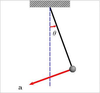

A pendulum and an oscillating spring-mass are two more examples.
Both cases show points of minimum velocity, which are as well the points at which maximum force and acceleration occur.

As you can see in the animation of the pendulum, the vector velocity is constantly changing magnitude and direction.
At each extreme of the pendulum the velocity is equal to zero therefore the magnitude of velocity vector is also equal to zero. But the gravitational acceleration is constant at every position of the pendulum. Therefore, the object is not completely at rest but momentarily at rest as it will move after an instant. In other words the object passes through the rest frame but isn't continuously at rest as it doesn't have time to rest. Words are tricky in physics. They sometimes project "mirages" in our minds...

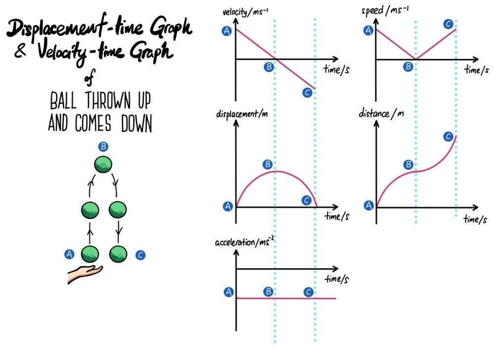

At maximum height, the velocity of the ball is equal to 0, but it doesn't continuously remain at zero for a continuous time period, even not for the millionth part of second….but the ball simply passes through rest.
Look at the velocity-time graph in the picture below. At point B , when the velocity graph crosses the axis v = 0. It is just for "one instant". Therefore, by passing through rest I mean the ball isn't at rest for a continuous time period. It is at rest only for a particular instant. The velocity starts increasing after that.
Thank you. This time you've removed the problematic word "frame". The ball passes through a condition of being at rest. Not through a condition of being in a particular frame.

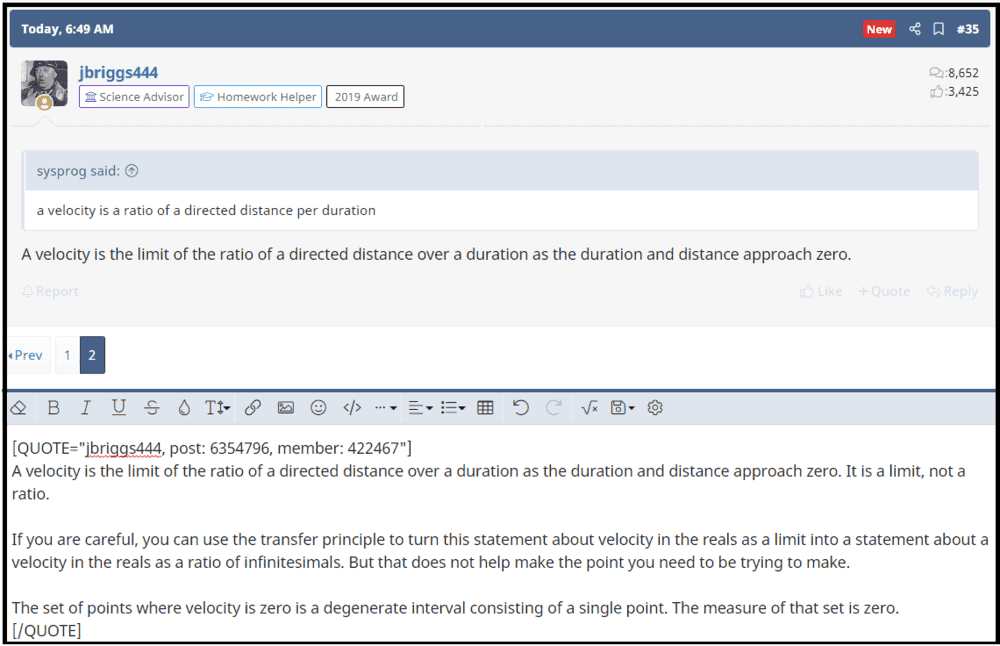

How might we without inconsistency envisage instantaneity? Is there physically such a thing as an 'instant'? If there is, does it have a duration of zero, or is its duration positive?
Physically? That's for experiment to decide. No experiment I can imagine can detect whether there is such a thing.
Edit: This article by @john baez indicates that there is no evidence that gives a conclusive result either way.
Mathematically? Sure. A course in real analysis will provide a great deal of insight. It's duration is zero.
I understand that to be conventional usage. In my opinion, it should be called something that doesn't also mean nonexistent ##-## it seems to me to be a misappropriation of the term 'zero'. I prefer 'infintesimal'.
As I said, a course in real analysis would not be amiss here. Zero or, in particular, zero duration is not a synonym for non-existent.
