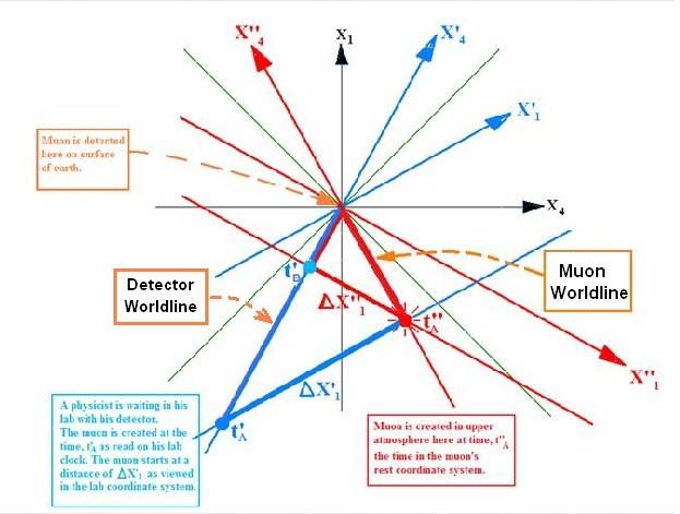

universal 101, It has been pointed out for you that events that occur in spacetime exist in all frames of reference--it's just that the coordinate values are different in different frames. It was pointed out that you should consider the worldlines of the various objects, i.e., detector and the various muon particles. All particles showing up in the detector for one frame will correspond to the termination of the worldlines of the particles, and those worldlines and termination events will be present in all inertial frames.
The process for one muon is shown as a spacetime diagram below. I could easily add in the coordinate axes for all of the other observers moving at whatever velocities with respect to the reference frame that you wish. You cannot give me a frame (or any observer) for which I cannot have included in my spacetime diagram (the observers of course cannot move at the speed of light or greater). For any other observer you give me my spacetime diagram will show you his indertial frame--and that frame will definitely include the muon detection event.
The diagram would get very messy, but I could also include as many different muons as you wish--all having worldlines that terminate in the detector. And every event will show up in any observer's frame that you wish to propose. You tell me your observer and his velocity and his coordinate system may be added.
The diagram would get very messy, but I could also include as many different muons as you wish--all having worldlines that terminate in the detector. And every event will show up any observer's frame that you wish to propose.
Thanks, and especially for the diagram.

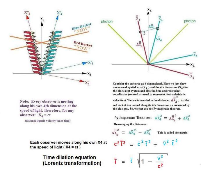

Here is one way of looking at length contraction and time dilation. In the description that follows, some physicists would accept this description as actually corresponding to physical reality whereas others will accept the description as a geometric picture that is consistent with special relativity but is not to be accepted as a literal description of the universe. That is, here I'll try to help visualize the sense in which space contracts and time dilates by resorting to a 4-dimensional spacetime universe--however, most physicists on the forum here would object to using this as a literal picture of physical reality, rather accepting it as a useful pedagogical tool.
In the spacetime sketch below I've tried to depict a red and blue rocket moving in opposite directions at the same speed with respect to some rest frame (the black frame with perpendicular coordinates). The rockets are 4-dimensional objects with fixed 4-dimensional geometry--their geometry does not change as 4-D objects, i.e., these objects do not shrink as 4-dimensional objects. However, in this universe model the observers have just limited 3-dimensional cross-section views of the 4-dimensional universe at any instant of time. And for some inexplicable reason (a fundamental feature of special relativity) these 3-D cross-section instantaneous views cut through the 4-D universe at different angles, depending on the slopes of the objects' worldlines (the slope of the worldline determines an object's speed--observers move along their worldlines at the speed of light). The red and blue rockets have the same slopes in the black reference frame, but they slope in opposite directions since they are moving in opposite directions.
Bottom line: Blue sees Red's rocket as being shorter than his own (Blue's). But the cross-section of the universe viewed by Red cuts through Blue's rocket in a direction that gives a cross-section length that is contracted by comparison to Red's. So, the dimensions of the rockets as 4-dimensional objects do not change at all--it's just the different cross-section views that give the appearance of contraction.
Clocks may be used to measure time along the world lines. Notice that the different cross-section views of the 4-D universe result in Blue observing Red's clock at a position that is much earlier along Red's world line than the position of his own (Blue's) clock along his (Blue's) worldline. Thus, Blue thinks Red's clock is running slower than his own. In the example below, using Blue's reference frame, we see that Blue is at clock position #9 while Red is at clock position #8. But, from Red's point of view (using Red's frame), we see that Red is clock position #9 while Blue is at clock position #8. Thus, 4-dimensional clocks don't slow down or speed up at all--different observers just have different cross-section views of a 4-dimensional universe.

I'm just going to go ahead and say it. Bobc2, do you use that picture in every SR thread you reply in?
