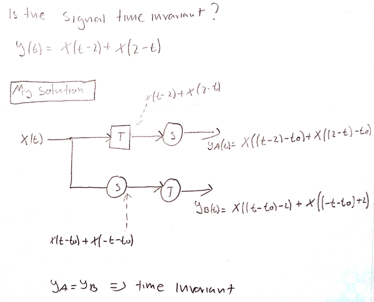

Huumah Messages 27 Reaction score 0 Thread starter Feb 23, 2013 #1 Can anyone help my to see why my solution is wrong because the in the solutions it says that it is not time invariant
mfb Mentor Insights Author Messages 37,499 Reaction score 14,384 Feb 23, 2013 #2 I don't understand what y_A and y_B are. Simple example: y(0)=x(-2)+x(2) y(1)=x(-1)+x(1) In general, those sums can be different.
