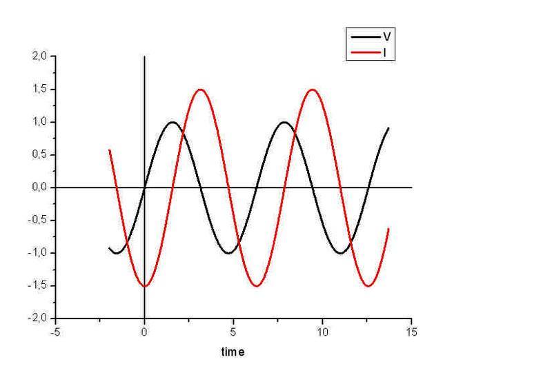

What does negative in i(0)=-V/(Lω) at t=0 signify ? Is it that the current is flowing in the positive terminal of AC voltage source at t=0 ?
Yes, the current and voltage are shifted in phase. At t=0, the voltage is zero, and the current is negative. But you can not speak about the positive terminal of the source as the polarity changes in every half period.
But at t=0 ,we can assign positive to one side of the terminal of AC voltage source and negative to other side .In that case current seem to enter from the positive terminal .
If that is not the case then what is the significance of current having a minus sign at t=0 ?
You can write '+' at one terminal of the source, and still, the voltage is positive for half period and negative in the other half. And it is zero at t=0. The current is positive if it flows out from the + terminal. The voltage leads the current on an ideal inductor. When the voltage is maximum, the current is zero. When the voltage is zero at t=0, the current is negative, so it flows into the generator at the positive terminal. At a little time later, the voltage is positive, and the current is still negative.
When you write the function representing the time dependence of the current, the sign belongs to the function. I=-V0/(wL) cos (wt).
ehild
Thank you :)
