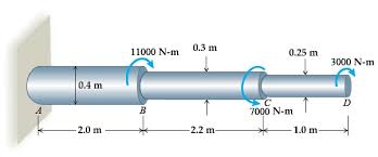

Here is a cantilevered shaft which is loaded by three torques:
Just like a force vector is an arrow (since it causes a body to translate in the direction of the force), a torque vector is a curly arrow (since it causes a body to rotate in the direction of the torque).

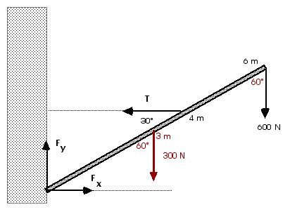

Here is a FBD for a 6m long crane arm that is hinged at the bottom left, it has mass 30kg and a 60kg mass hanging from the top end. There is a cable holding it up that has tension T. Your mission is to find the tension T...
Even though the arm is subject to forces it can be treated as a torque problem. For example..
The crane arm isn't accelerating (it's static) so the torques must sum to zero. We can write this equation for the torque about the pivot..
Torque due to 30kg mass of arm + Torque due to 60kg mass + torque due to cable = 0
If we define clockwise as +ve and assume g =10m/s/s that becomes..
+ 300*3*Sin(60) + 600*6*Sin(60) - T*4*Sin(30) = 0
and we can solve for T.
