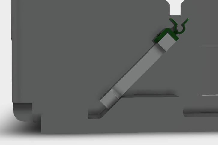

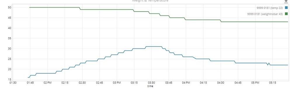

Hi JR, I am working with Dylan on this. We have the load cells screwed onto a PP mount that is shaped like a triangle. The load cells are mounted at 45 degrees. This is because the box it is in can be positioned either horizontally or vertically. The item we are weighing hangs off a bar straddled between the load cells, sitting on a clip attached to the top of each load cell. We are seeing today that after we tighten the screws, and allow a number of thermal cycles to take place, the load cell loses their accuracy. We have to date been putting this all down to the K factor and had not considered the mounting or tightness of the screws. Would be very interested to have a discussion with you and share some photos.
Is PP = polypropylene? If so then it is not surprising it is thermally unstable.
You must attach an aluminium gauge to a rigid aluminium mount.

CAD drawing attached - the prototype mount is made of PETG. The production product will be made of PP. There is not washer etc - they are screwed direct to the mount.

Your graph looks like either the plastic or perhaps an adhesive, is cold-flowing at the higher temperature.
We must verify that the sensitive axis is independent of the mounting.
1. Why is the strain gauge mounted at a diagonal?
2. How many strain gauges are used?
3. Where is the manufacturer's datasheet for the strain gauge?
