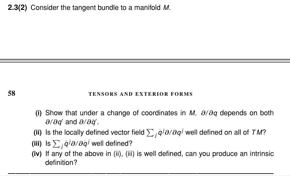

So while reading T. Frankel's "The Geometry of Physics", I was going through the part on cotangent bundles which ended with the definition of Poincare 1-form. The author argued that cotangent bundles are better suited than tangent bundles for some problems in physics and that there is no natural isomorphism between them, that is, one has to include a metric as an additional structure to relate vectors to covectors. He said that some objects naturally live in the cotangent bundle(for example canonical momenta), etc.
So at the end of that discussion there is an exercise that is(I presume) supposed to show that an equivalent of Poincare 1-form doesn't exist on a tangent bundle. The precise statement of the exercise is given in the screenshot below.
The exercise doesn't look hard, but still, when I look at the (i) I don't see why ##\bf{\partial/\partial q}## would depend on both ##\bf{\partial/\partial q}## and ##\bf{\partial/\partial \dot{q}}##. ##q## is a letter reserved for the coordinate basis. ##\dot{q}## is a generalized velocity(that is, the on tangent bundle the coordinates are of form ##(q,\dot{q})##).

Antarres said:
Summary:: Confusion about coordinate transformation on a tangent bundle
In tangent bundle there is a canonical vector field:
$$\dot q^i\frac{\partial }{\partial \dot q^i}$$
it is invariant under mappings that preserve tangent bundle structure
(i) is wrong
Okay, so, this canonical vector field is what's defined in (iii). However, can you please elaborate why (i) is wrong? Let's say that (i) is wrong, then we supposedly have, under coordinate change:
$$q'^i = q'^i(q^1, \dots , q^n)$$
implies on the tangent bundle:
$$\dot{q}'^i = \sum_{j} \left(\frac{\partial q'^i}{\partial q^j}\right)\dot{q}^j$$
if (i) is wrong, I suppose that means:
$$\frac{\partial}{\partial q^k} = \sum_{j} \left(\frac{\partial q'^j}{\partial q^k}\frac{\partial}{\partial q'^j} + \frac{\partial \dot{q}'^j}{\partial q^k}\frac{\partial}{\partial \dot{q}'^j}\right) = \sum_j \frac{\partial q'^j}{\partial q^k}\frac{\partial}{\partial q'^j}$$
i.e. the second term vanishes(in doesn't make sense that the first one vanishes). Then let's look at the field defined in (ii).
$$\sum_i \dot{q}^i\frac{\partial}{\partial q^i} = \sum_{i} \left(\sum_j \left(\frac{\partial q^i}{\partial q'^j}\right)\dot{q}'^j \sum_k \left(\frac{\partial q'^k}{\partial q^i}\right)\frac{\partial}{\partial q'^k}\right) = \sum_k \dot{q}'^k\frac{\partial}{\partial q'^k}$$
So then it looks like the field in (ii) is well defined on ##TM##, so it would be a second canonical vector field, right? That shouldn't be the case, I think.
Excuse me for double post, but I think I resolved it.
Under coordinate change in ##M##: ##q'^i = q'^i(q^1, \dots q^n)##, the inverse change would be ##q^i = q^i(q'^1, \dots q'^n)##. These changes imply on ##TM##:
$$\dot{q}'^i = \sum_j \left(\frac{\partial q'^i}{\partial q^j}\right)(q)\dot{q}^j \quad \Leftrightarrow \quad \dot{q}^i = \sum_j \left(\frac{\partial q^i}{\partial q'^j}\right)(q')\dot{q}'^j$$
From here we have in (i):
$$\frac{\partial}{\partial q^k} = \sum_j \frac{\partial q'^j}{\partial q^k}\frac{\partial}{\partial q'^j} + \frac{\partial \dot{q}'^j}{\partial q^k}\frac{\partial}{\partial\dot{q}'^j}$$
No terms vanish since ##\dot{q}'## has explicit dependence(from the Jacobian) on ##q##.
Then we have in (ii):
$$\begin{align}
&\sum_k \dot{q}^k\frac{\partial}{\partial q^k} = \sum_k \sum_j \left(\frac{\partial q^k}{\partial q'^j}\right)(q')\dot{q}'^j \left(\sum_i \frac{\partial q'^i}{\partial q^k}\frac{\partial}{\partial q'^i} + \frac{\partial \dot{q}'^i}{\partial q^k}\frac{\partial}{\partial\dot{q}'^i}\right) \\ &= \sum_j \dot{q}'^j\frac{\partial}{\partial q'^j} + \sum_{ijk}\left(\frac{\partial q^k}{\partial q'^j}\right)\left(\frac{\partial \dot{q}'^i}{\partial q^k}\right)\dot{q}'^j\frac{\partial}{\partial \dot{q}'^i}
\end{align}$$
Here the second term won't vanish for same reasons the second term in (i) didn't vanish.
Meanwhile we have for ##\frac{\partial}{\partial \dot{q}}##:
$$\frac{\partial}{\partial \dot{q}^k} = \sum_j \frac{\partial q'^j}{\partial \dot{q}^k}\frac{\partial}{\partial q'^j} + \frac{\partial \dot{q}'^j}{\partial \dot{q}^k}\frac{\partial}{\partial\dot{q}'^j}$$
Here the first term vanishes because ##q'^j## is explicitly independent of ##\dot{q}##, while the second term simplifies to:
$$ \frac{\partial \dot{q}'^j}{\partial \dot{q}^k} = \frac{\partial q'^j}{\partial q^k}$$
Hence in (iii) we have:
$$\sum_k \dot{q}^k\frac{\partial}{\partial \dot{q}^k} = \sum_k\sum_j \left(\frac{\partial q^k}{\partial q'^j}\right)\dot{q}'^j \sum_i \left(\frac{\partial q'^i}{\partial q^k}\right)\frac{\partial}{\partial \dot{q}'^i} =\sum_j \dot{q}'^j\frac{\partial}{\partial \dot{q}'^j}$$
So this is well defined, as @wrobel said, it's called canonical vector field. When I said the exercise was supposed to show such a thing doesn't exist, that was my wrong assumption, since I didn't really know what to expect as a solution. Turns out the exercise is supposed to show its existence.
I think my confusion mostly came from losing the count of explicit/implicit dependencies, I didn't see how the second term in (ii) wouldn't vanish, but the first term in (iii) would. I think it's good now, but it would be nice if someone more knowledgeable checked it.
