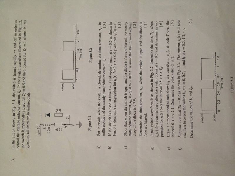

I have a circuit containing an inductor, 2 resistors and diode in series however there is also a switch.
I thought that when the switch is closed there would be no current flowing through the right side of the circuit (resistor and diode) and therefore for part a) the time constant is L/R=10/20=0.5ms and steady state inductor current is just V/R=0.5A.
However, this can't be the case in order to do the show that question in part C), so I was wondering if someone could just explain the circuit to me when the switch is open and closed. Thank you!

What, in toto, is the question?
Never mind, I got the picture straightened out. Stand by ...
How it works: at t=0 swirch S is closed and the current thru the inductor increases. At t = 0.5ms S opens and the inductor current continues thru the diode until iL = 0 at t = TZ. The current stays at zero until S closes again, at which point the cycle repeats.
How about doing (b)?
Part (c) is misleadingly stated. The current thru the diode is -10 mA only if the switch stays open for a long time.
(d) is an important computation. You will need it for part (e).
Part (f) is more challenging because the current thru the diode does not ever equal zero.
