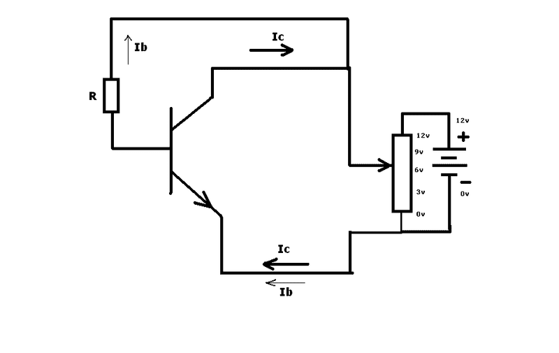

Conventional current vs electron current has nothing to do with how a transistor operates.
Power still comes from the battery and any current that leaves the battery has to return to it.
In this diagram, the current splits into base current and collector current. R just limits the base current.
At the emitter, the currents combine again and return to the battery.

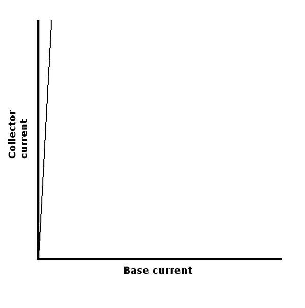

The base current controls the collector current. I have drawn these currents on the same scale to show that the collector current is a LOT bigger than the base current.

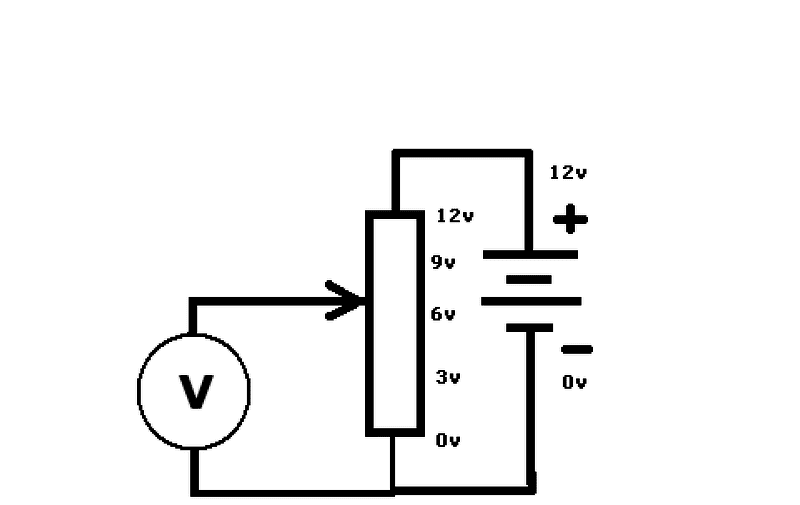

The voltmeter draws very little current compared to the current drawn by the transistor. Ideally it should draw none, but all voltmeters draw some current.
A rheostat used as in this diagram is called a potentiometer. (A rheostat only uses two connections but a potentiometer uses both ends of the device and the sliding contact.)
It is a long piece of resistance wire wrapped on an insulating cylinder and a connection is made to each end and to a sliding contact which is available to tap onto the wire at regular intervals (ususally every turn) along its length.
If a potential is placed across this potentiometer, it divides evenly along the length of the wire and you can use the sliding contact to vary the voltage out. This is just like a variable voltage supply.
Some current is taken from the potentiometer and flows through the transistor. A lot more current flows in the potentiometer and returns to the battery. Note that this is only for testing the transistor and would not be used for normal operation of a transistor.

It looks like you have a problem with electrical circuits, not just transistors. This can be fixed.
In the above diagram can you see that if you move the slider on the potentiometer from the bottom to the top, the voltage between the slider and the bottom connection will increase?
Forget the transistor for a moment, but I have redrawn the currents as electron flow.

You understand how a potentiometer works but you don't understand how it produces a variable voltage?
Its only function is to produce a variable voltage, so you do not understand how it works.
That website explains it very well.
As you increase the voltage across the base emitter junction of a transistor (or any other diode) in the forward direction, the current through the diode starts off at zero and stays there at zero until the diode starts to conduct at about 0.6 volts for a silicon diode and at different voltages for other types of diodes. Above 0.6 volts, the diode current will increase rapidly and be limited only by the available current.
You need a variable voltage to test the transistor and a potentiometer gives you a variable voltage. So, why is that a problem?

There is a current flowing in the potentiometer, so the voltage that comes out of the slider is just as real as the voltage that comes out of the battery.
In the above circuit, the voltmeter doesn't draw any current. What does it read when the slider is in the centre position on the potentiometer?
If you put a transistor across the voltmeter, why would it not get the same voltage on it as the voltmeter?
the voltmeter will draw little current and measure 6V as the remaining 6 would have already dropped.What u r saying is applicable only if we draw current from the battery.
But in transistor the battery is just applying electric field and not drawing current.
