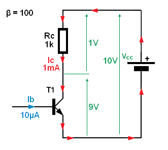

As for the saturation maybe this example explain why saturation occurs:
I assume β = 100
At first we forced Ib current to be equal to 10μA
The resulting collector current will be equal to:
Ic = β * Ib = 1mA and voltage across Rc resistor:
VRc = Ic * Rc = 1V
Vce = Vcc - Vce = 1V (II Kirchhoff law).

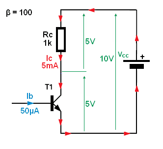

Now let see what will happen when we increase the base current to 50μA ?
Well the Ic = Ib*β = 5mA (what a surprise) and corresponding Vce voltage is 5V.

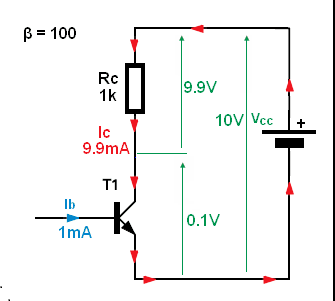

Now it can be seen that if we increase the Ib current (Vbe must also increased) -> the collector current Ic is increased too, and collector voltage (Vce) decreases. As a side note this is why we say that CE amplifier gives 180 degree phase shift.
Now we can wonder, what is the max Ic that can flow in this circuit. We knows Ohms law, so Ic_max = Vcc/Rc=10mA and that give as Ib_max = Ic_max/β = 100uA
But if we force larger base current the BJT will enter the saturation region because there is not enough supply voltage (saturation is reached when increasing the base current no longer makes the transistor conduct any more current).
See another example
As you can see Ic = β*Ib = Ic = 100*1mA = 100mA don't holds any more. I hope you know why.
Because now we have Rc in the circuit and Ohm's, Kirchoff's law must also holds (BJT cannot conduct any more current than Vcc/Rc). BJT tries to create a situation in which the collector current is Ic = β*Ib = 100mA. The mechanism by which it does this is by controlling the "resistance" of the collector-emitter path through the BJT. But this time the BJT no longer has any tools in its bag to increase the collector current up to the point it would like it to be. So the Vce voltage stops dropping and the collector current is less than β*Ib. Our BJT is full ON ( operate in saturation region).

Jony130 said:
Yes, the MOSFET's will indeed behave completely differently. I know that it may sound strange and confusing but the term "saturation" has a completely different meaning for the FET's in general. In short:
FET's "saturation" = "linear region" or "active region" in BJT's.
BJT's "saturation" = "linear region" or "ohmic region" in FET's.
So the Full ON MOSFET's will i behave just like a very low valuer resistor (lower than 1 ohm's if you use a proper MOSFET with low Vgs(th) voltage). Therefore drain current is equal to the source current and this is equal to Vcc/(Rc+Re) = 4.5mA.
Try read this
http://www.ittc.ku.edu/~jstiles/312/handouts/Applying a Drain Voltage to an NMOS Device.pdf
http://www.ittc.ku.edu/~jstiles/312/handouts/Creating a Channel for Current Flow.pdf
I assume β = 100
VRc = Ic * Rc = 1V
See another example
